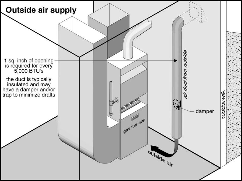

This morning I noticed what smelled like natural gas exhaust coming from the room where my hot water heater is. Checked it out and found that Im getting a backdraft through my flue. It does vent, but b/c of the cold weather the first 30 seconds or so of running it has to warm the air to draft. This puts some exhaust into the house. Once it gets warm it drafts fine. My question is, should I create a fresh air supply like pictured below and seal the room/closet? Or does someone have a better solution? Also the flue pipe runs straight up and is a dedicated line for the water heater.

For a draft to happen, replacement air has to come from somewhere. Ideally the replacement air originates from a different area from the exhaust. Otherwise you pull in exhaust and smell. If your house is too tight, no draft. This is why people with woodstoves and fireplaces sometimes report that the smoke smell they have goes away when they crack open a window.
Thats why i was thinking of giving the room its own fresh air supply and sealing the door. Just didnt know if anyone had any other recommendations.
From outdoors is the best. You can use indoor air per code but the communicable spaces have to have 50 cubic feet of volume per 1000 BTU/h of the appliance. Residential applications rarely meet this provision. You can use either one or two permanent openings to accomplish combustion air. Either one within 12" of the ceiling with a free area of 1 square inch per 3000 BTU/h or two openings, one within 12" of the ceiling and one within 12" of the floor with somewhere between 1 square inch of free area per 2000 BTU/h or 4000 BTU/h depending if the openings are horizontal or vertical.

Ok, so i definitely need to bring in outside air. Ive been calling it a room, but its more like a small closet. Barely big enough to house the water heater. The water heater is 40k BTU in a 4x3x8 room (not even 96 cuft). Also going by your numbers with 40K BTU's Id need at least a single 6" inlet.

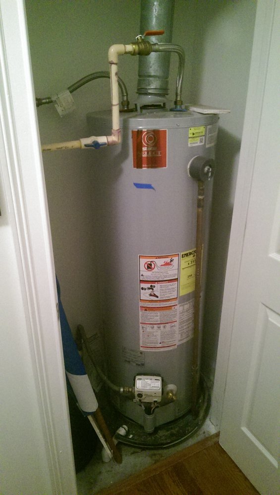

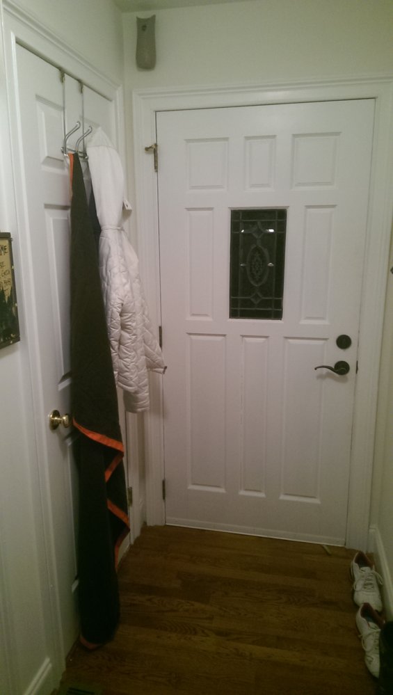

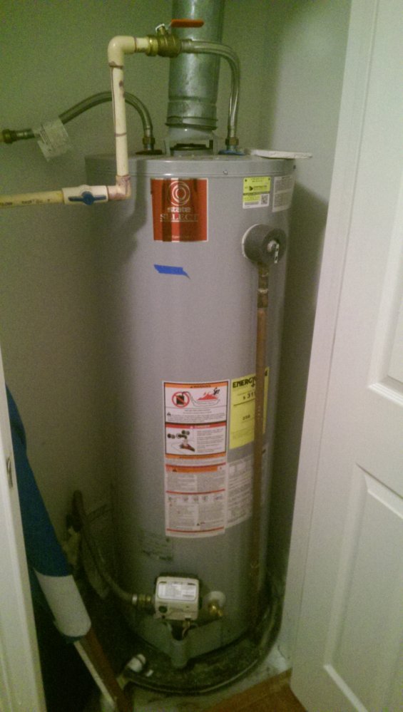

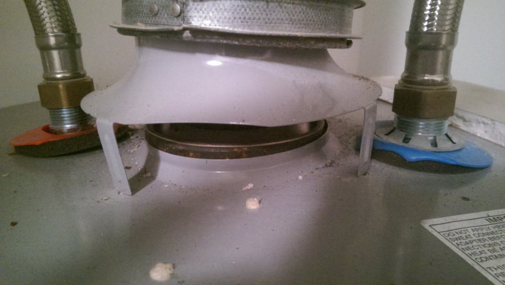

The door opens in the foyer right by the front door. I had thought about venting the door but my main issue is the back drafting into thehouse. With my crawl space being sealed the house is much tighter, I've noticed a decrease in my utility bills since last Jan. already. I have been burning a fire lately too and thats probably why air is being pulled through the kitchen vent and hwh flue.(didnt quite hit me at first). That's why I was planning on just sealing the door with weather strip and providing the hwh with outside air for combustion. Here's a few pics....
Front door, closet to the left
HWH
melted indicators from backdrafting

So wait, there are NO openings in that closet? Just the gas vent on top? That's absolutely terrifying. Another item of note that I do not see, do you have a shutoff valve for the gas line before it runs into the water heater regulator?

One of the problems with gas water heaters is combustion (fresh or outside air) air and flue gas air . One goes in one goes out. there are rules to do it properly. Can you put water heater somewhere else? Like in an outside storage area or attic? Sealing the crawl space changes air into house. Your water heater problems may have alerted you to a larger problem. Is one wall of closet an exterior wall if so then cut two proper size holes in wall to outside, one high and one low with insect screens. Then install weather stripping on closet door. You also can add some outside air to your hvac unit to add more air to house interior which will help when kitchen hood, bathroom fans, and clothes dryer are operating.
There is a shut off where the gas line enters the room, but there is no other air inlet except the gap beneath the door. I havent ever noticed the backdraft until the other day (the coldest day of the year). Moving it is pretty much out of the question bc then I'd have to re plumb most of the house. I kinda like having it where its at also. It's centrally located and doesnt take long to get hotwater anywhere in the house. Think I'm just gonna do the 2 vent method and seal the closet door.
