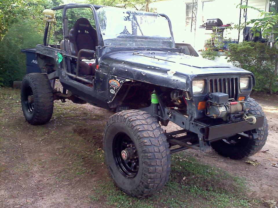

This is what it looks like with the narrowed front and drw hubs. You can run stock dodge or H1 hummer wheels with no steering issues. If you are interested in this setup I still have the drw hubs I removed from mine and I also have a set of H1 wheels.
About time for some tires aint it, slick? :driver:
