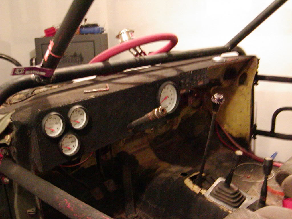

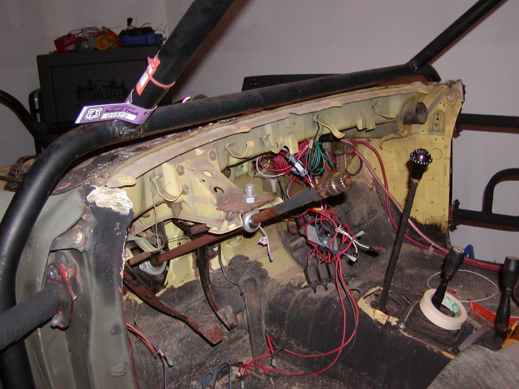

Started with the dash. This was a nasty mess of aluminum sheet, plywood, and fiberglass :shaking:.
Before

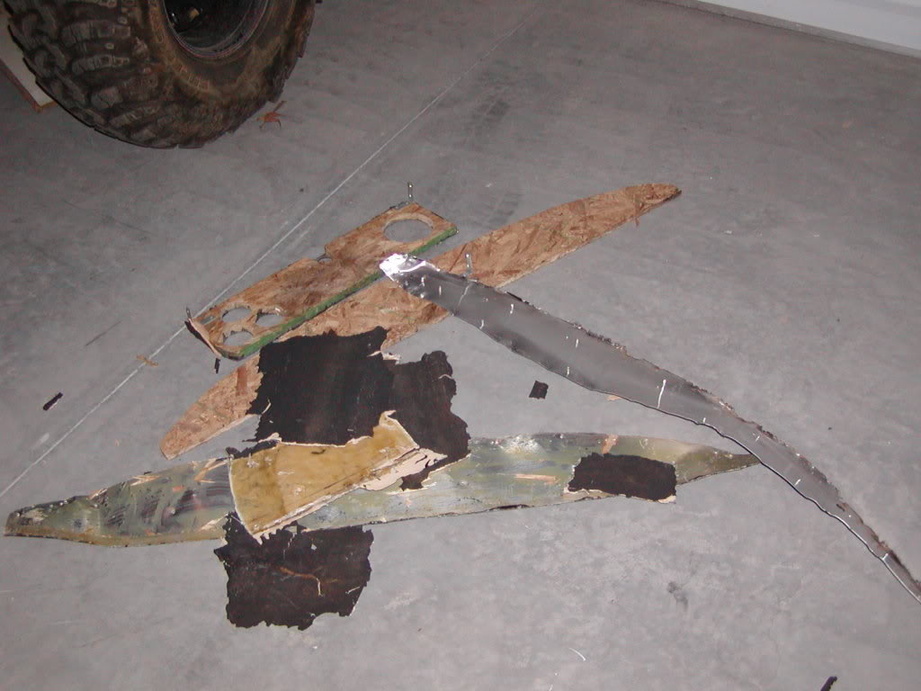

Part of the old dash awaiting transport to the nearest junkyard

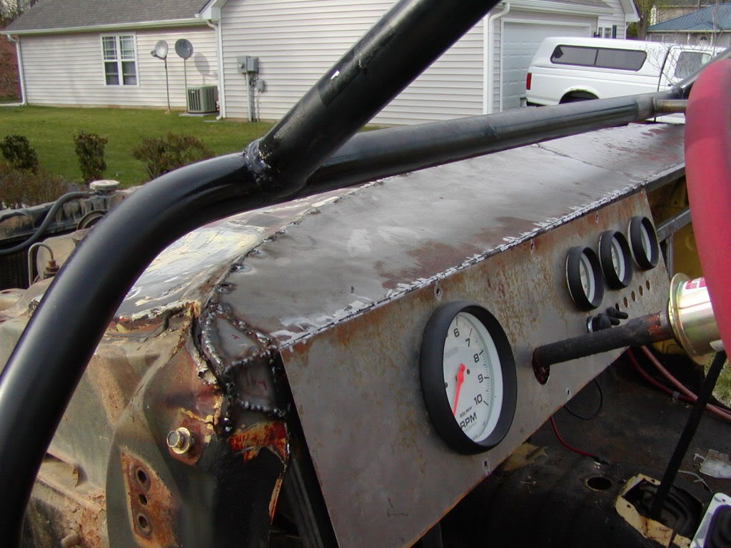

Current progress of new dash

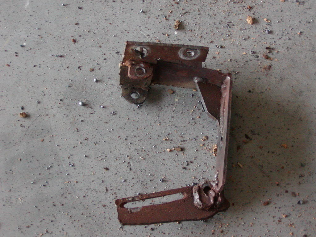

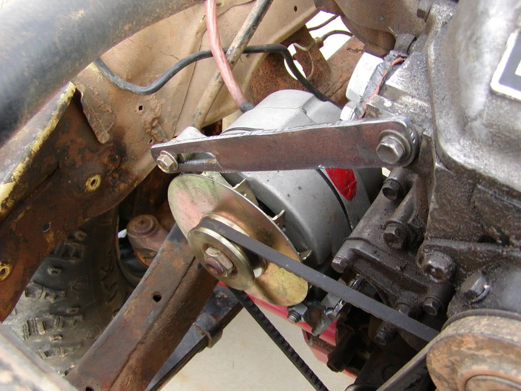

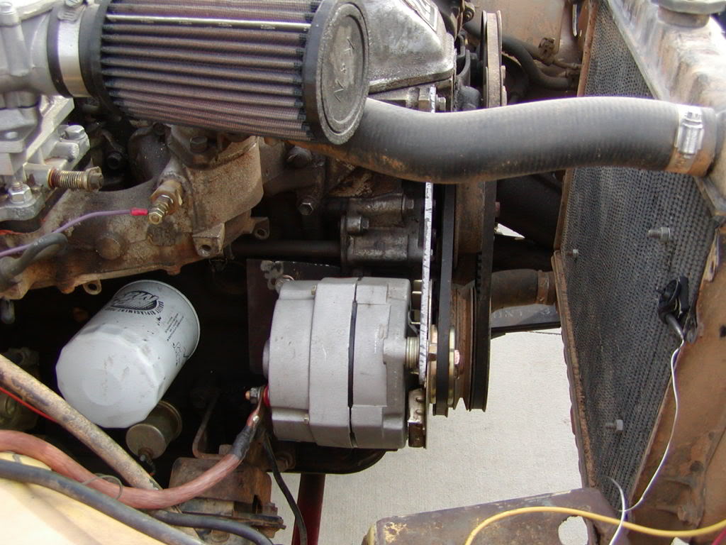

The PO made a bracket to hold a 1-wire alt on the passenger side of the 22R, but it looked like it was welded by a 5 yr old. The belt tension was not adjustable because the curvature of the slot was wrong (cut out by a grinding disk). Finally, the placement of the alt was all wrong. The pulley on the alternator was about 1 inch forward of the corresponding crank and water pump pulleys so the belt was all crooked. I don´t even know how it worked as well as it did. :shaking:
Removed bracket
new bracket

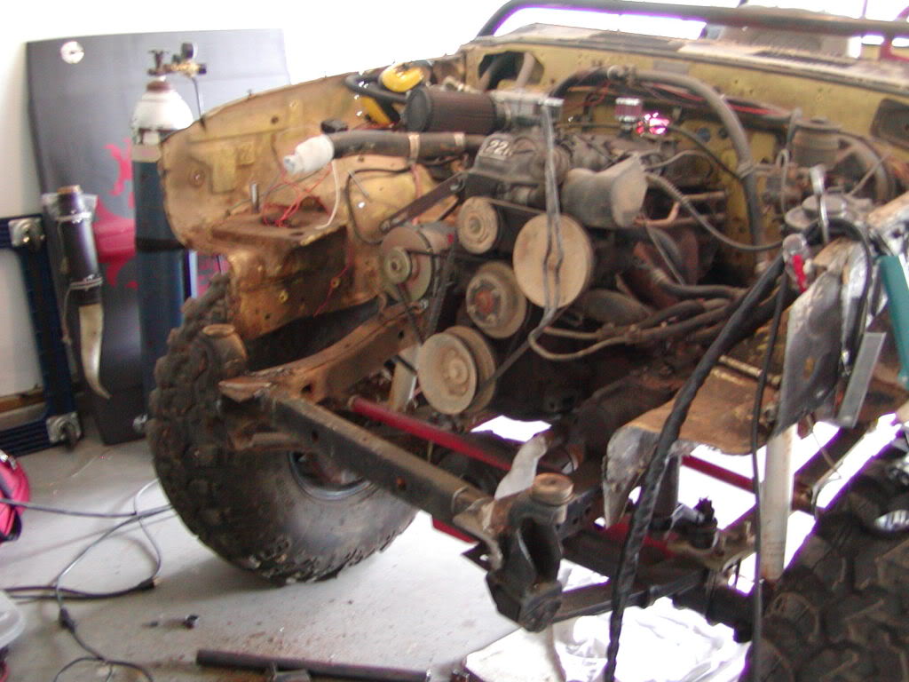

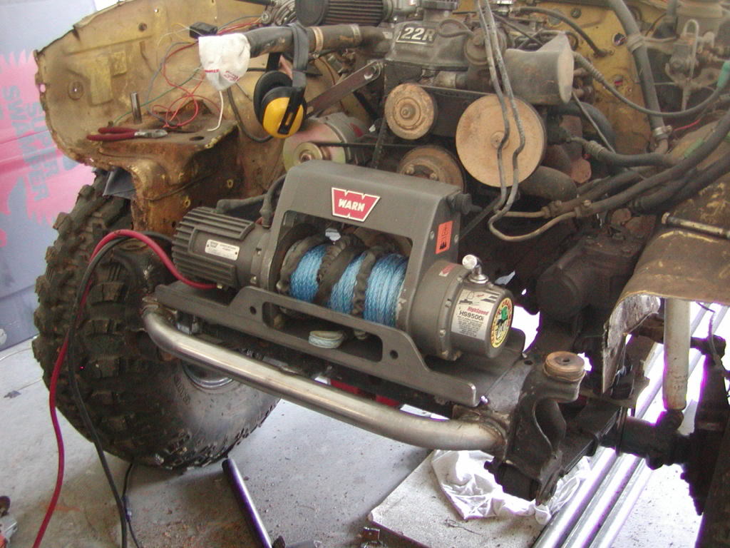

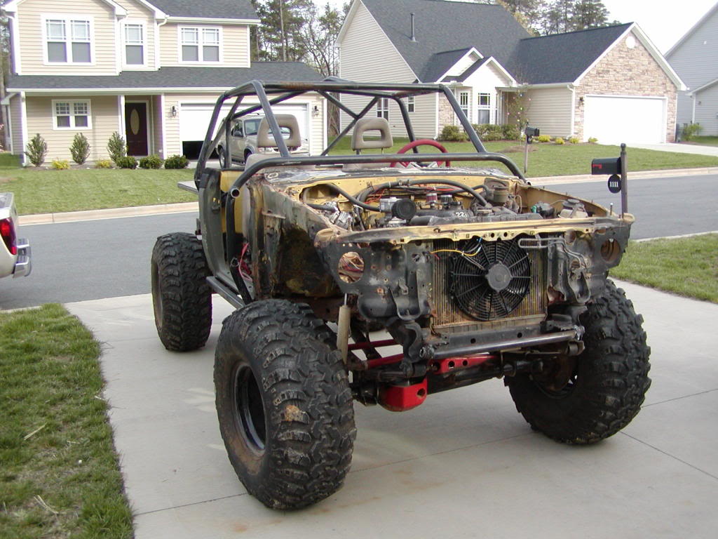

I don´t like the way the front half of the exo is, so I am slowly changing it. In the interest of maximizing approach angle, I am recessing the winch into the grill and putting the rad in the bed. I am going to narrow the nose a little bit too, maybe 6 inches or so.
What I started with
cut off the from the dash forward
more teardown
as it sits now. started the tube work and using a BudBuilt winch plate
I haven´t really made up my mind about the front tube work yet. I think I will go with the stinger still, but a smaller version. I also found some rust around one of the body mounts that I need to fix up soon. Maybe I´ll get to it one day...

what are you going to do for radiator lines? ive never really thought about this that in depth, but it would be nice to open of the front of my truck like that since I'm about to re do my tube work as well.
Thanks 1stgenxxx, I sent you a PM.
For the radiator lines, I plan to purchase some bulk hose from NAPA and do it that way. If that doesn´t work out, I will either go the steam hose route or steel tubing (in that order).
