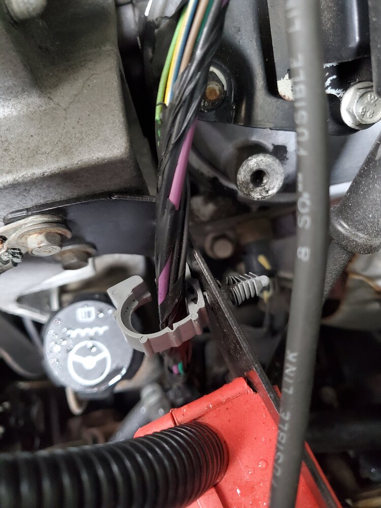

Check the harness that goes down in front of the driver's side head. It's a common pinch point and there are a few grounds in that bundle than can cause a dead skip or even kill it. Check battery terminals and the rest of your grounds too.
This is what that bundle looked like on my 6.0. It randomly died a few times and wouldn't restart (when it was raining) and I'd pull that away from the bracket and it would fire right back up.

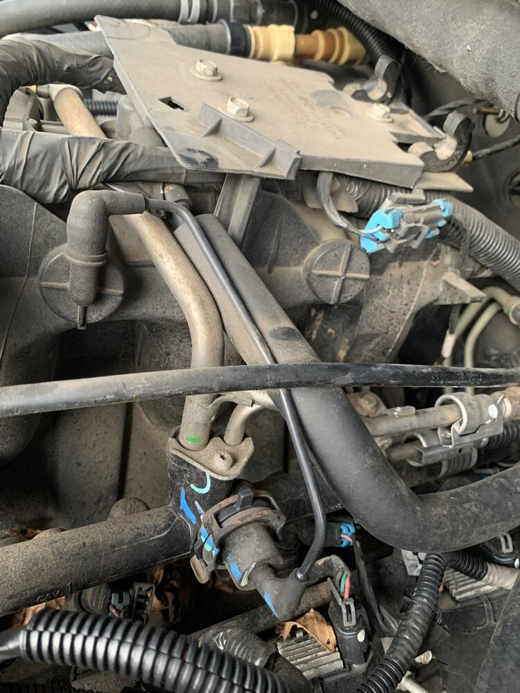

Here’s what I’ve found today. Fuel pressure with ignition “on” is around 45psi, running it drops to 25….now I thought if the pressure regulator was working properly, then when you remove the vacuum line from it, the pressure spikes? Is that correct? I removed the vacuum line and pressure stayed the same

after seeing the pics, Im even MORE convinced Mike is right
