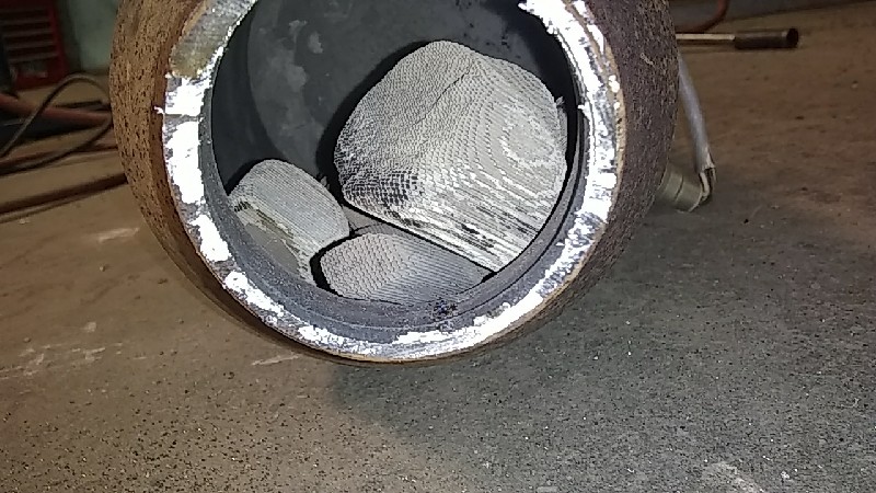

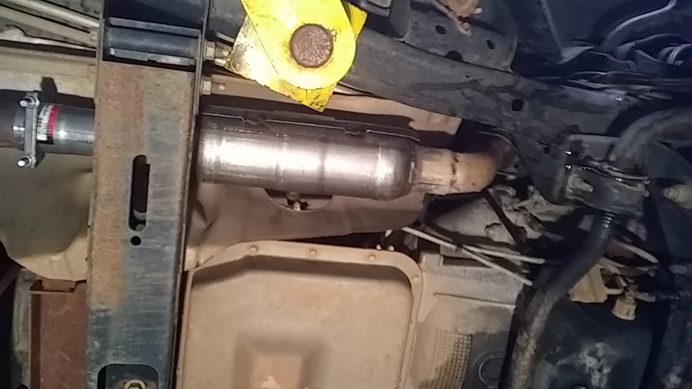

Ok so I've got a 06 expedition 5.4
No codes other than misfire.
Fuel is good gasoline, no water.
Fuel pressure/volume good. (Delivered 2.5 gallons in 2 minutes!)
New plugs/coils.
Timing good. Just did chains/phasers.
Hard hard stumble almost dies when given wide open throttle, even in neutral. Misses on cyl 1234. Sounds good at idle. No exhaust gas in coolant.
Removed upstream o2 (plugged cat?) But, No change. Unplugged MAF, no change.
Fuel trims @ 0% on Bank 1.. bank 2 11% (don't recall +/-)
Ideas? I'm fed up with it. Compression test & leak down my next step I guess.
