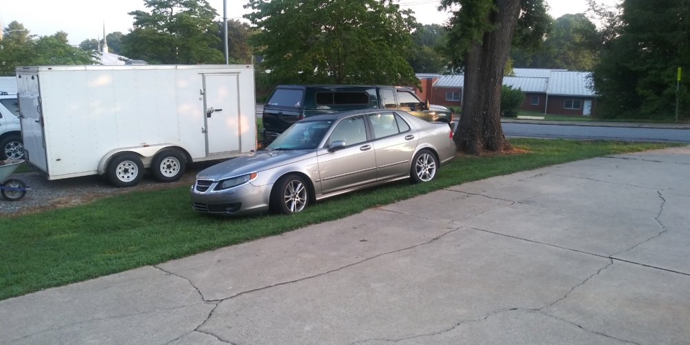

Sorry for the confusion. I have the rack just need to install it. It is owned by a family friend I'm trying to help. Need procudure.
