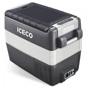

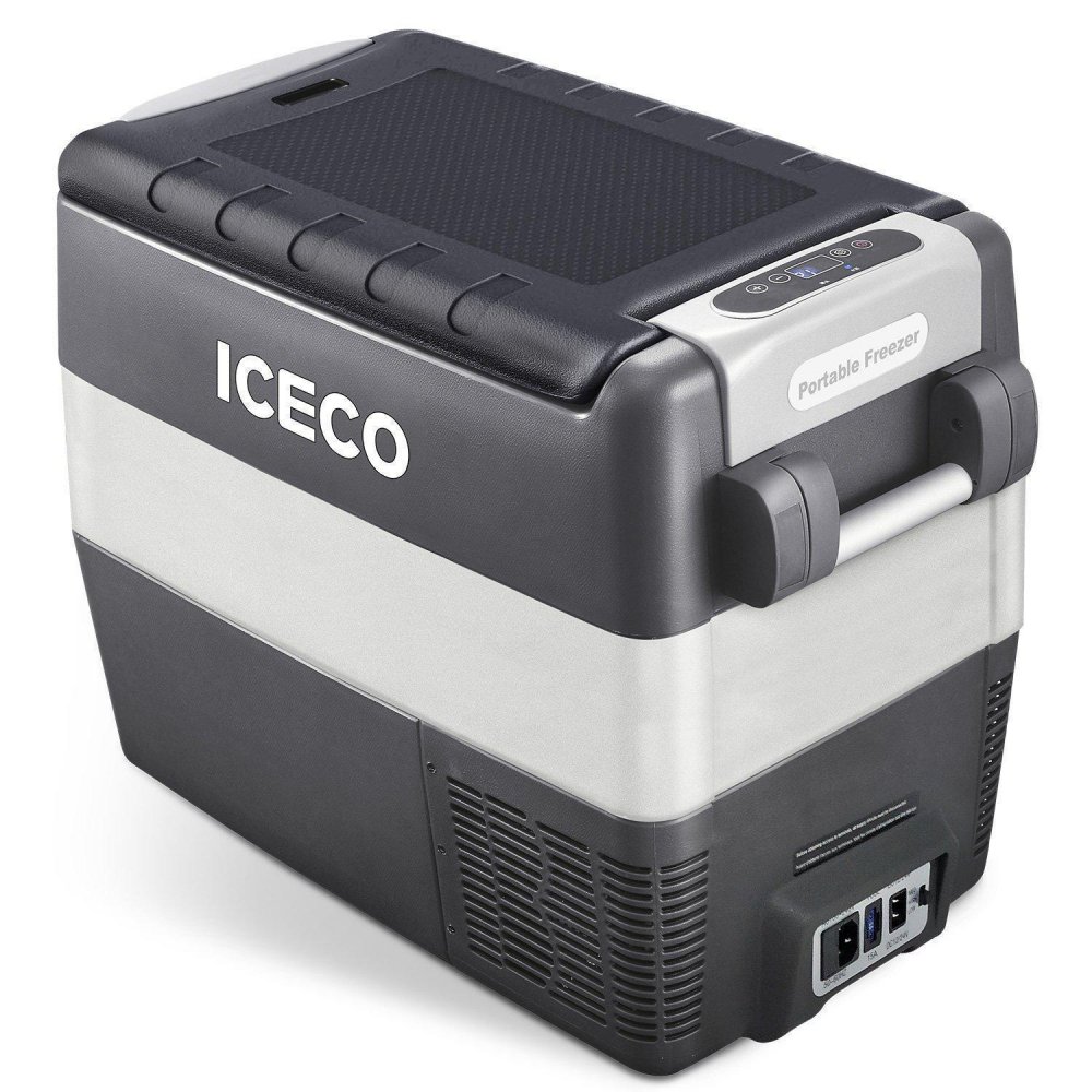

Just pulled the trigger on and ICECO JP50
Hopefully here before the weekend. We'll see if UPS can not drop kick it between here and cali.
@BigBody79 Curious as to how this works for you. Going to drop the hammer on 1 eventually.
Few things to consider:
Even though the fridges come equipped with a cigarette plug, the cigarette plugs in most vehicles aren't equipped to provide 4-5a without a significant voltage drop. I ran a 10ga wire in the suburban direct from the battery to the fridge so it would see at least 10.5v with the engine off. ARB sells a kit for this that's pretty fairly priced (if you have an ARB).
Experiment with your specific fridge to determine the lowest temp you can set the thermostat and not have freezing. That should be your default setting. It's a cold plate system, so the spot next to the plate (usually down in the bottom somewhere) will be the coldest, and it's warmer the further away you get. Our thermostat is set for 32F. Stuff up top might only be 40F.
Load it a day or so before you leave with pre-chilled items. The fridge is perfectly capable of cooling warm things, but it's heat rejection abilities are limited. If you dump a 12pk of room temperature beer in it mid-week, your bacon is going to spoil. See also the note above on power draw.
The fans on the compressor are usually the first point of failure. They're just shitty 12v computer style fans and are easily replaced. This is less of a concern if your fridge is going to live inside the vehicle where it won't see much dust and dirt.
Second trip out. It has been wonderful. We’ve got it set at 28 to keep the milk from freezing. Nice to have meats, cheese, eggs, and condiments cold and not swimming. Can’t barely hear it run. Even when it’s in the house cooling down. Seems to be very energy efficient.
