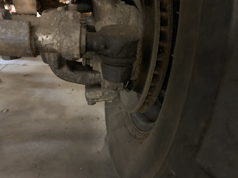

The 15x8s I had on mine, before going to 38s with 15x10 needed grinding on the backing plates and the calipers. They were 3 1/2” back spacing I’ll see if I can dig up some pictures from over 10 years ago.
Don't know if I've got pictures (close-ups anyway) of the 15x8s I ran on mine years ago...I had a 10 bolt front, 3.5" backspacing on the wheels. I had to grind the calipers. I didn't have to hit the backing plates, though. Definitely had to take some off the calipers.
I’ve actually still got the backing plates, which even them had to have about 1/16” taken off them. I can’t remember the back spacing but 3 1/4” or 3 1/2”

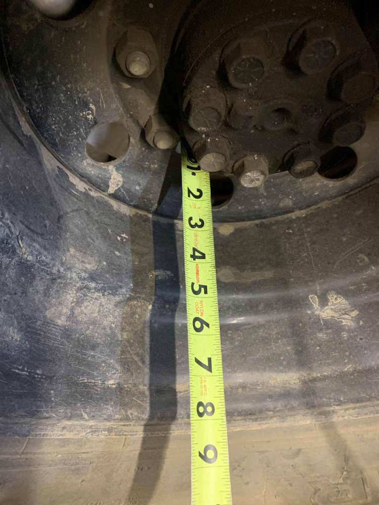

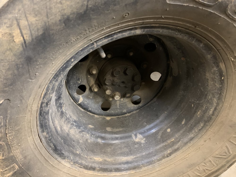

I have a set of 15x10 8 lug with 2.5 inches backspacing that didn’t require any grinding on 10bolt or Dana 60
Not going to say all wheels are the same tho

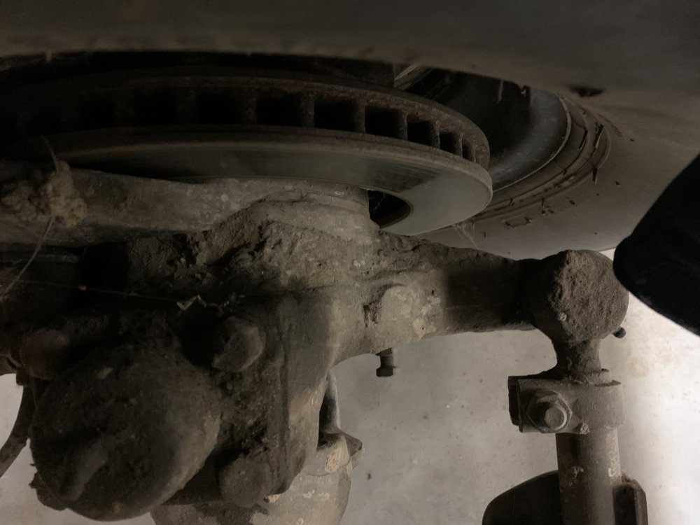

Do you have a picture of the wheel mounted for a offset reference. Tryin not to lift this thing tryin to stay close to stock height
You can see the brake rotor looking under the truck. They are not for wheeling if that’s the plans you’ll hit your rotor on a rock. I’ll try to get a picture for ya.
