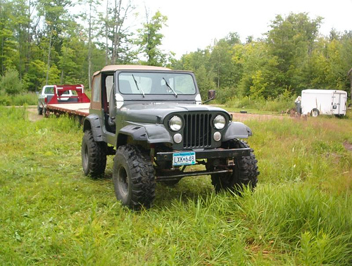

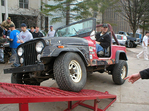

Paid $500 for it 3 or 4 years ago. Swapped tubs and drove it around school for a week or two.
After the first build, it looks halfways decent

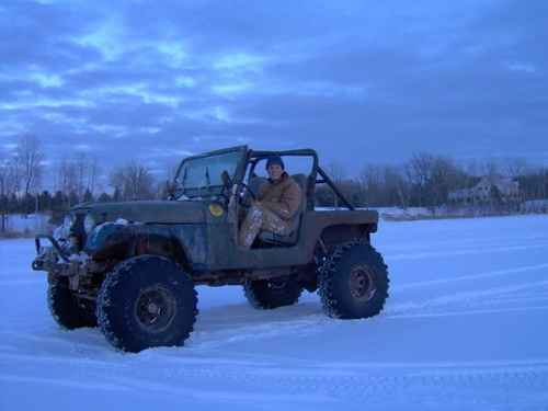

Then it went down hill...
What it is now:
Front/rear Dana 44, 5.38 gears, full spool rear, detroit front, 100" WB, TBI 350, sm465, twin stick Dana 300, 38" TSL's, Warn x8000i,

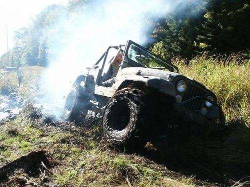

Blew my 4th 258 in January 06 after graduation while cruzing 60mph on a local lake in northern Minnesota. Sold most of the motor and tranny parts and started collecting junk for a Chevy swap.
Blew the motor a day after this shot

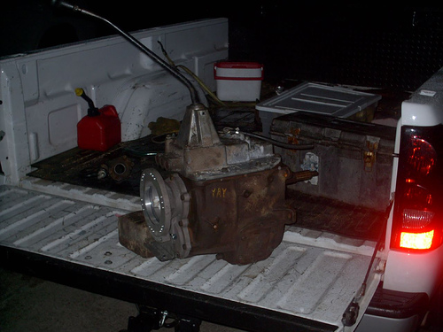

465 with adapter to Dana 300 installed on my tailgate.

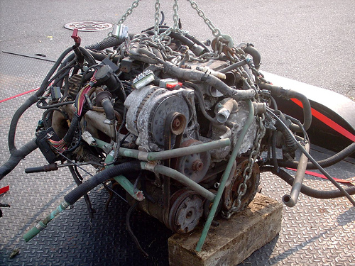

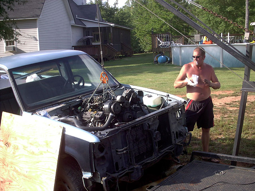

1989 350 TBI removed the day I sold the LT1 down in Atlanta
Ready to put the 350 in

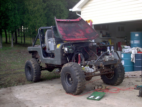

I collected enough parts and the 465 has been sitting in the back of my truck since July so I figured it would be nice to start putting shit together.

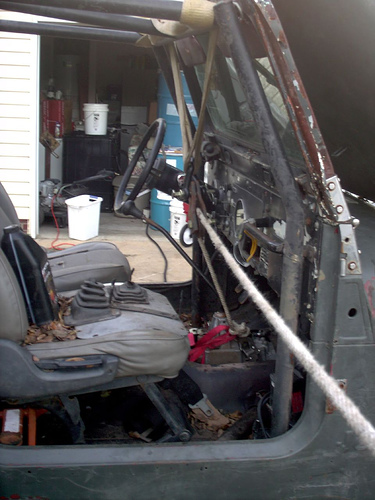

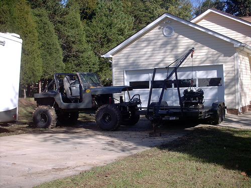

We towed the jeep to the driveway. This is one of the few times I havn't done major work on the jeep in the grass or in the snow. I am beginning to like concete.
The jammer is coming in handy again. When I was matting the tranny, I had the winch controller under the jeep so i could raise and lower the motor angle. That was nice.
I wondered how even two big guys can put a 465 up onto the bellhousing. I don't even know how to support it to jack it up. So what easier way then to use a 3/4 ton suburban to get it into place....

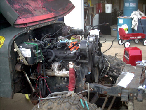

Here's the motor in it's knew home.

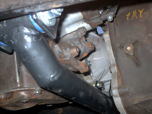

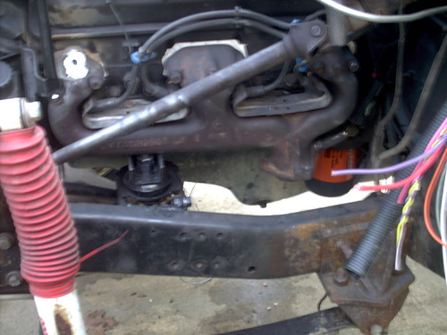

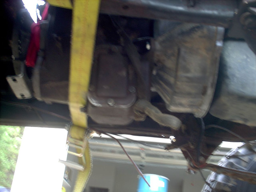

And here is a clearance shot. Should hang only a few inches below the stock setup.

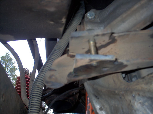

Crossmember. Gained 3 inches or more of clearance by not using the stock mounting system.

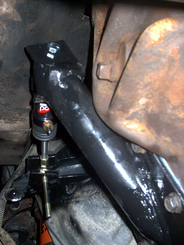

Took a lot of calculations and fabrication to get the hydro clutch set up. But all the work paid of and I didnt have to redo anything and adjustment took 3 minutes.
Its 100% neccessary to get a driver's side manifold from a non IFS (or non 4x4) TBI motor. Otherwise it wont fit between the frame rails.
Few more mod shots of the clutch

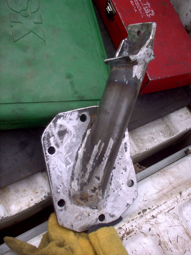

This one bolts to the side of the 465 and replaces that inspection plate.

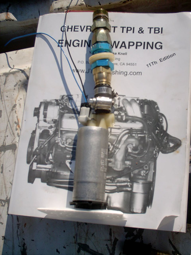

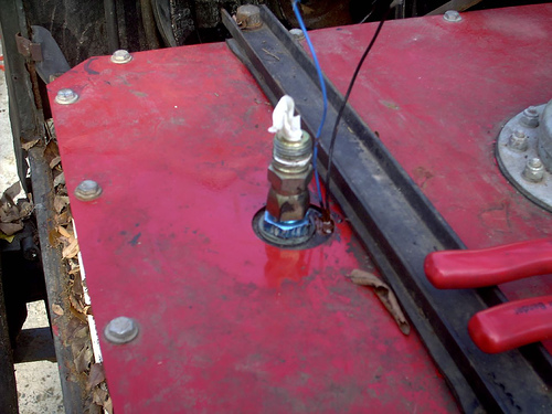

I had to modify my fuel cell to fit a GM in-tank pump. Not much room to work with here. This set up ended up falling apart because I was trying to go from 1/2 hose to 3/8 barb. I ended up having to by a -8AN flare to -6AN barb.
as it sits in the tank

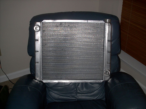

A tru-kool aluminum radiator. Very inexpensive and it appears to be good quality. Bought from Speedwaymotors.com for like $170...
Looks good. Nice setup.
nice work
