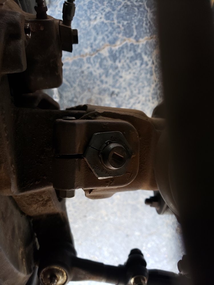

The answer I can provide for those Camber adjusters is to pull the clip, pull the pinch bolt, then use a pry bar and rubber mallet to beat them out. Not sure if thats the right way to get them out, but I can say that they did come out that way.
To get them back in .. I beat them in with a sledge hammer.
Take note of the position prior to putting them back and dont tighten the pinch bolt until you adjust the Camber doo dad !
