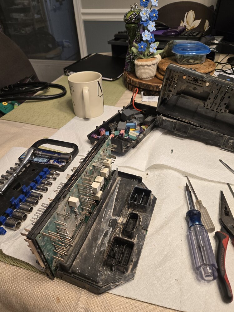

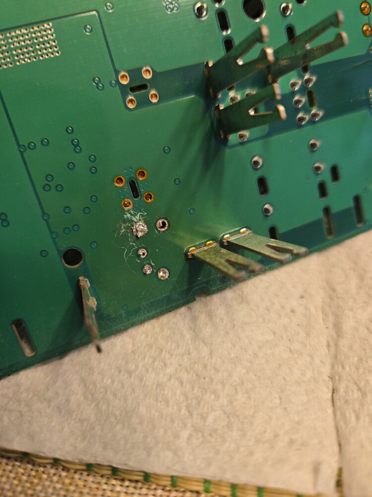

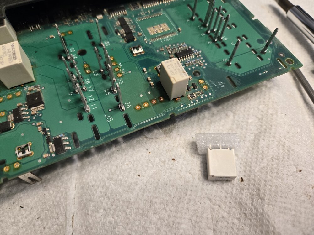

Mine lost the fuel pump relay last winter, I pulled that thing out and replaced the relay on the board myself but I "do" PCB soldering work somewhat regularly so it was no big deal aside from one of the damn pins did not want to give it up. Waiting on those stupid little relays was more of a pain and I am sure the rebuilders have them by the hundreds on the shelf, so there's that. Everything else is working but I bought some additional relays if anything else decides to take a crap.
