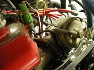

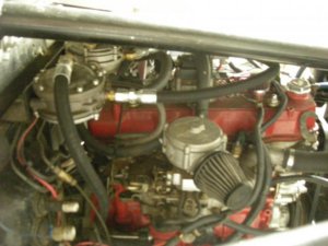

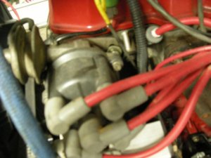

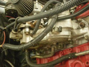

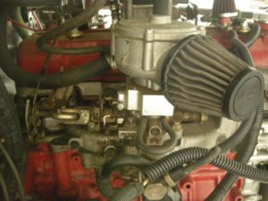

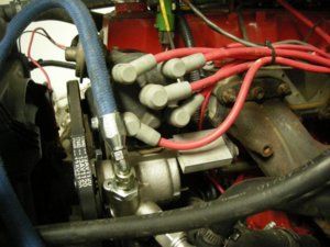

hope these help.as said before you dont need any ofthem. the only one is the vacuum line going to the lockout if you have a vacuum lockout. the lines on the power steering pump i never connected when i was using the factory pump and had no issues.hope the pics help sorry not the best had to use my cell the wife lost the digital.
yes i do have a vacume lock out, so ill need only one and shouldnt i need to hook the vacume lines from the carb distributor somewhere on the intake too?
not really i did not and mine has just as much power as most efi trucks do.but its up to you. all that i have hooked up is the 2 wires off the distributor going to the ignition coil.
