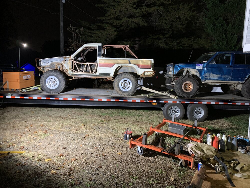

I’ve never torn into a wiring harness before.
I want to run the motor, gauge cluster and lights only. All other stuff I don’t want or need.
I was trying to get the ‘85 4runner going and was not getting power to the fuel pump so I just ran a wire from the ignition directly to the pump. I re-used the factory ground and it fired right up.
Would anyone want to come over and drink beer/make some side $ and help me strip out everything I don’t need?
I’m nervous. lol
