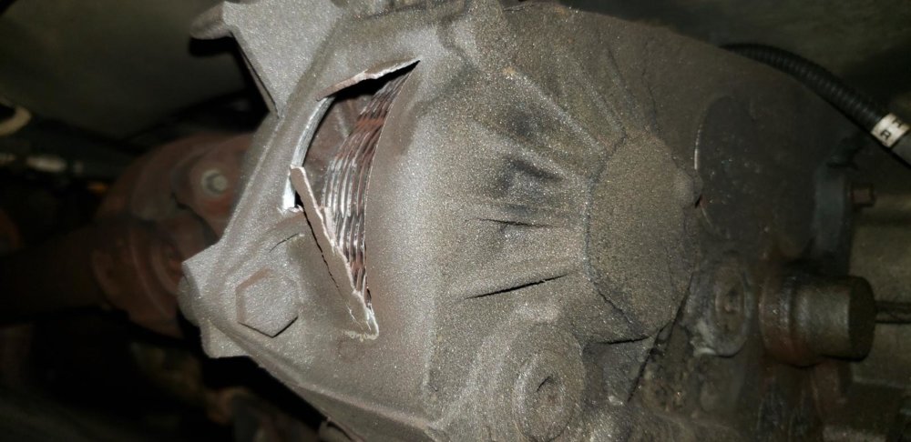

77GreenMachine Phillip Talton Joined Mar 30, 2010 Location Trinity, NC Jun 6, 2019 #3 When I say broken, my front axle shifted backwards and the drive shaft split my case.

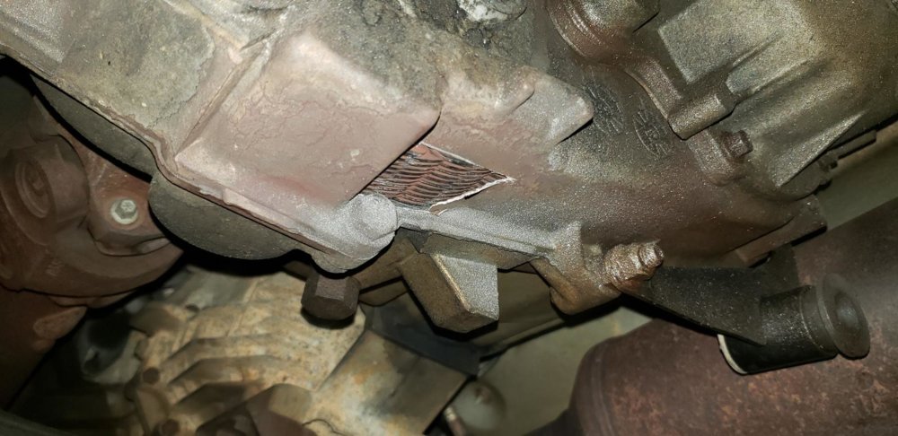

junkxj Well poop!!!!! Joined Nov 19, 2014 Location Mexico!!!!!! Jun 6, 2019 #5 Hopefully one difference between his and yours would be that the one you have doesn't have large holes in it.....
