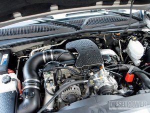

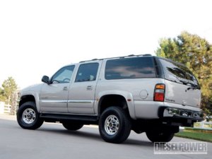

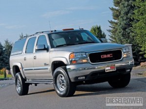

http://dieselworksllc.com/page3/page3.html this is all we would ever need. but its so far out of price range its stupid.
$80,000 PLUS D&H
just a thought though..
I have heard that the MPG in the 8.1 and the 6.0 are similar, except when towing. I am only going to be towing once a month at best, but I will be in stop and go commuter traffic every day going back and forth to work.
That 6.6 would be perfect! I wish they would put a diesel in a full size SUV again, be it GM or Ford.
