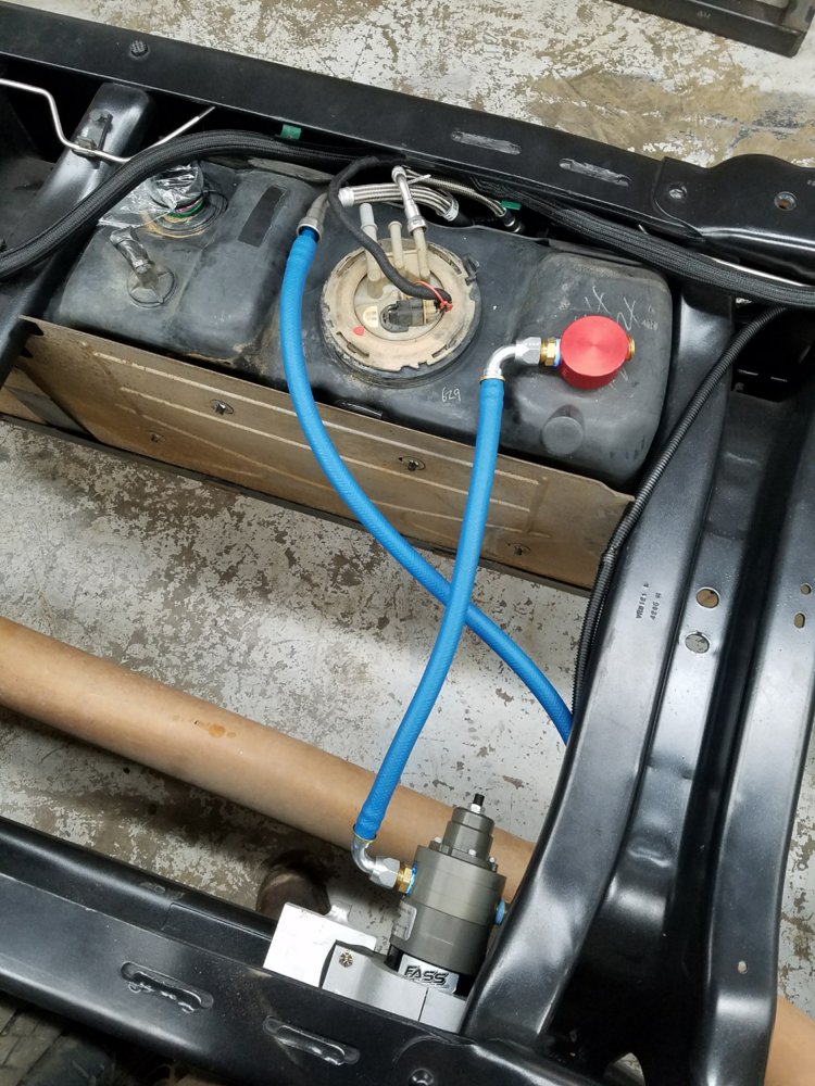

On my 03 I used a 1/2" fass pickup that comes with their universal pump kits. It's the red thing below.
