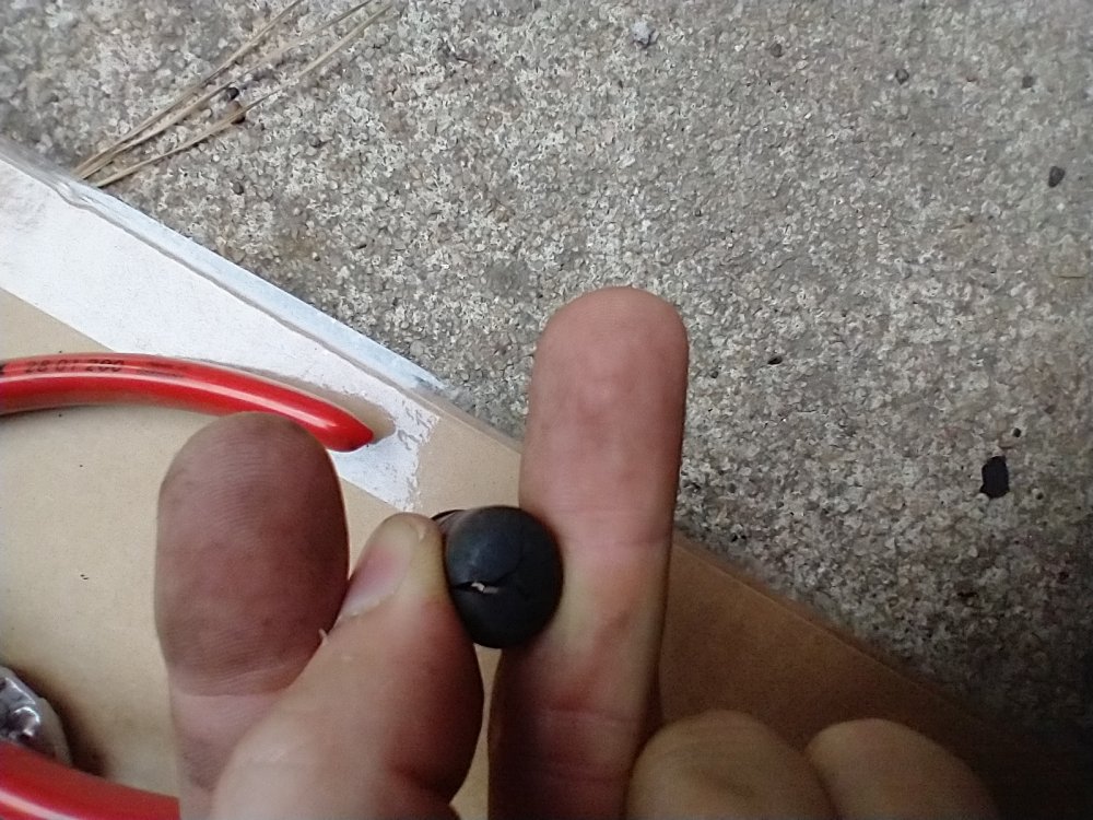

Found this rubber cap that covers an aux. Vent tube on the pump....it was completely cracked, tossed a vac. Cap on there and found the tank was under pressure after driving around (but no leaks).
Bought a new gas cap, zip tied the vac. Cap on and filled the tank.....no gas smell or leaks!
$18 in supplies (I couldn't find my vacuum cap kit, had to buy new).
And I got to do it all sitting under the truck, no bed pull or tank drop.....I couldn't be happier!
