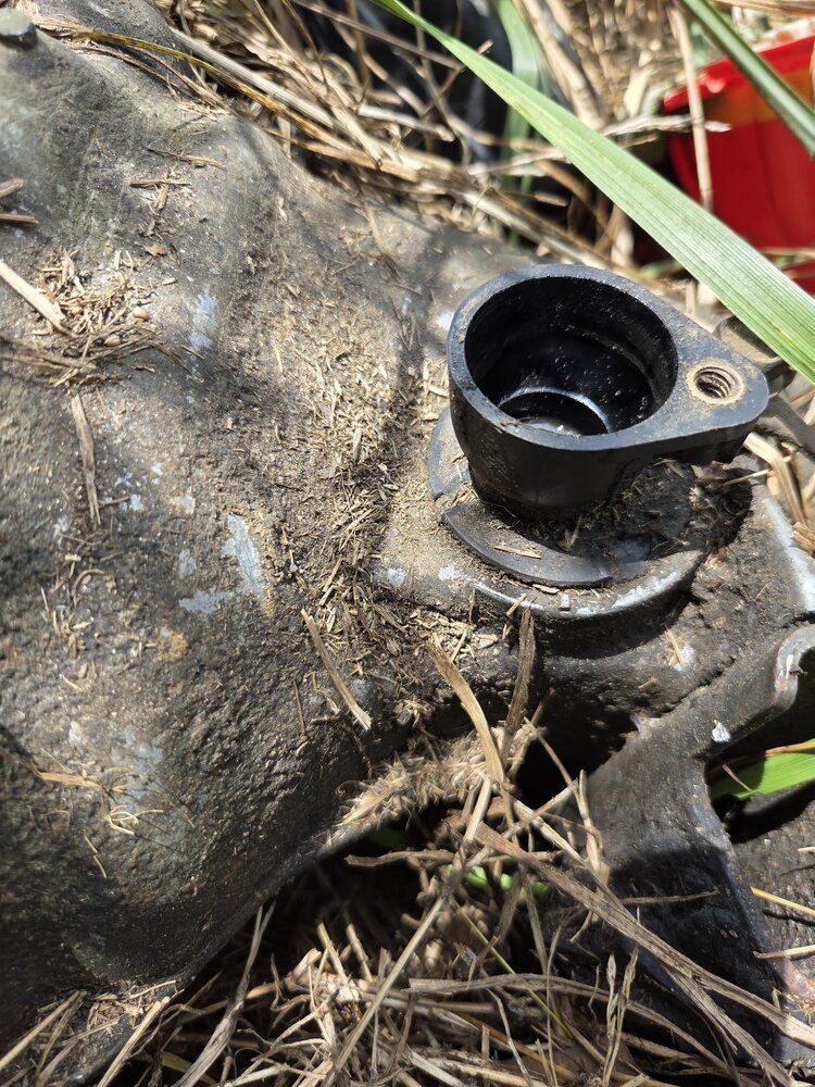

Like the title says, trying to get the sensor and housing off to put in the replacement transmission. I would think it should screw out, but it doesn't want to turn and I dont want to break it. Thanks.
Edit. Im an idiot. It just pops out, but mind the drive gear or you'll have to fish it out with the grabber like I did.
