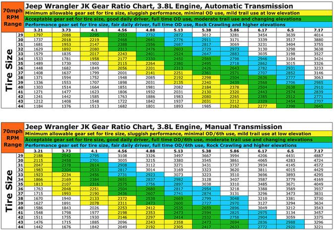

I guess that even a Sahara or Rubicon would want/need lower gears above a 33" tire?
As Jody said, Yes. 4.10 with the stick is tolerable on 35's, barely.
My 09 is an auto and the PO put in 4.56's and on 35's its still pretty underpowered on the highway. Wish he had installed lower gears, but the engine has been good other than it heating on me once and now it has a tick.
