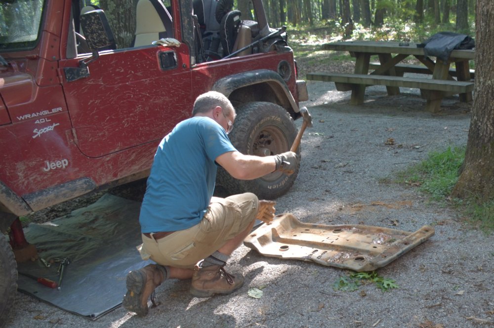

The benefit of a 3-link is that it's cheaper than a 4-link, so it's a decent budget option. They also have packaging benefits in certain applications (again, that is often driven by cost/benefit). The downside is that when they fail, they do so catastrophically. We wheel with our kids, so catastrophic failure isn't an option. We had a guy in our group on Fins & Things lose a front upper. It took out both coilover shafts, the oil pan, and the driveshaft. We spent all morning cobbling it back together just so he could spend about a grand with an off-road tow truck company. His "once in a lifetime" trip was ruined on day one because he wanted to save a couple hundred bucks on an upper link. Cyd still thinks Fins & Things is a shitty trail. I imagine this has something to do with it.
