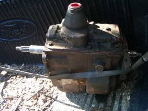

Picked up a T18 with a granny gear for $100 yesterday. Has the short input shaft. This should double my crawl ratio and bolt right up. (going form 31:1 --> 66:1)
