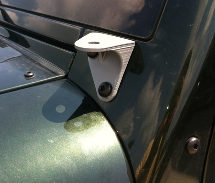

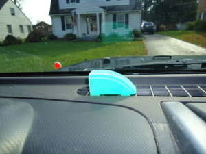

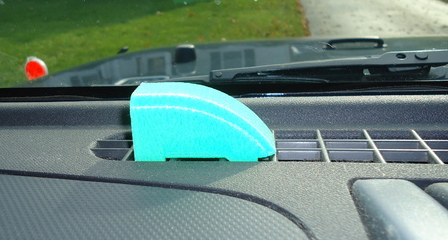

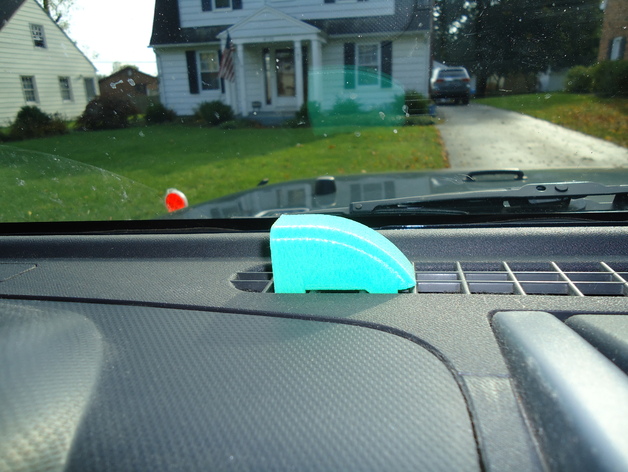

Whats the blue thing?

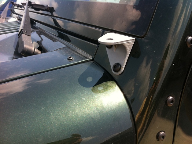

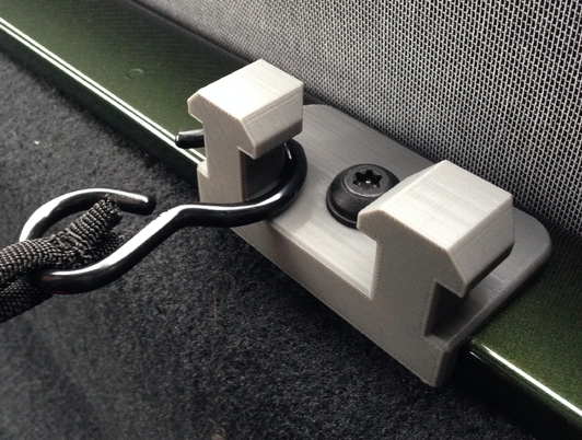

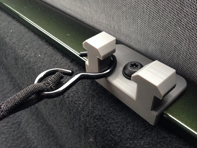

I think it needs to be said that both of the gray parts are not really optimized to be made out of plastic. You can do whatever you can think up, and whatever your CAD skills allow, so making something like that bracket on the windshield hinge (I don't actually know what it does) could take more advantage of the 3D capability, instead of being something that can be simply fabricated out of flat plate. I would just make it out of flat plate instead of printing it, because then it would be indestructible.
The other part needs some filleting at the corners, because those sharp 90degree internal corners are stress risers and very weak.
Both parts could use some metal hard points at the holes so they don't crush under bolt loading.
There are some really high strength, high temp etc FDM materials that are great for durability (e.g. Ultem) but you gotta be willing to pay $$$ for it.
For the isolator mounts, adding a layer of rubber insulator will go a long way to compensating for the brittleness of plastic

To clarify the pictures show items i have already made for my jeep. The greenish looking vent one is for the defrost. In the JK the location of where the air comes out to defrost the windshield takes longer to hit over in the corners. With these pieces it re-directs the airflow over into each corner of the windshield so there is equal defrost on the windshield. The Grey piece on the outside of the windshield is for a light mount and the other grey hook thing is what i have in the back of the jeep to hold down a number of things. I use the existing hardware for the hardtop and they just bolt right into place. the filament I get is pretty strong and holds up well under pressure. I was thinking if anyone had created the D-Ring and High Lift Isolator they would have all the specks so I can just punch into the printer.
