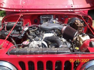

Its not to bad, I got my motor mounts from www.novak-adapt.com and also had a complete donor rig, granted mine is a yj frame not a cj, but still pretty much the same deal, you will have to use a mopar transmission also, The power from the 5.2 is great
Ha ha ha Lee, you have a 1992 jeep XYZCJ-8. I like that.. Its a mutt
... a bada$$ mutt!
