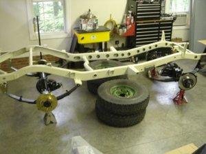

It's been a while since I had anything good to update on. The chassis was blasted and primed. This weekend, we stuffed longfield goodies and ARB's into the front end with all new bearings, gaskets, seals, and a shackle reversal. The rear was also done with an ARB, rear disc kit, and fresh bearings and seals. Everything was bolted to Alcan springs with U-bolt flip kits and anti inversion shackles on the rear.
Next in line is mating the Ramjet to the 700r4 for driveline mock-up.
Slow, but progress is good.....
lookin good Jim!! more pics......

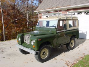

btw, you still got the green Rover you did the resto on?
