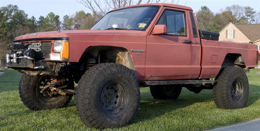

figured it was time to post a pic of the MJ up here.
Just recently got done swapping the BA/10 for a 23 spline AW4, np 231 with SYE.
Other stuff its got
Scout d44 rear, welded
newer HP30 front, lockrite
35s, some skids, winch, plenty of dents, lots of cutting, more to come
i have a bender on the way, so it will soon have a cage and more complete bumpers hopefully.
will have it at DPG this weekend for only it's third trip out, first since the tranny swap.

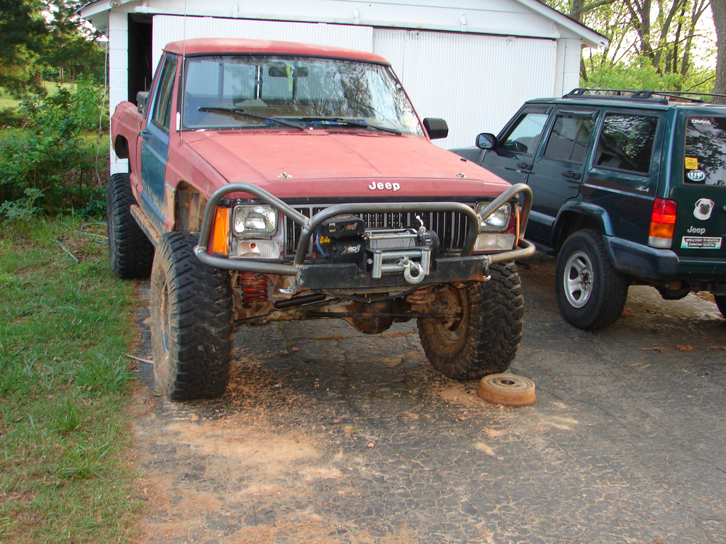

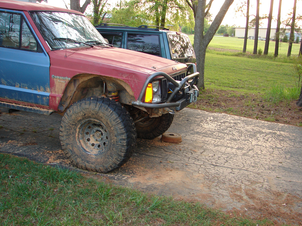

I've got a buddy getting an 88 MJ to build, so I have one question. Are you on stock springs and lotsa sawzall, or is there some lift there? I like the stance of yours, low with the same size tire we're shooting for, for now.
Ive got a springover in the rear on stock springs, and somewhere around 4-5 inches of peiced together lift in the front.
Lots of sawzall, still running stock bumpstops so it has a bunch of travel. I did have to trim considerably more in the front after that pic to really fit the 35s. The good thing about the mj is in the rear there is no real structure to worry about like an xj, so cut away!

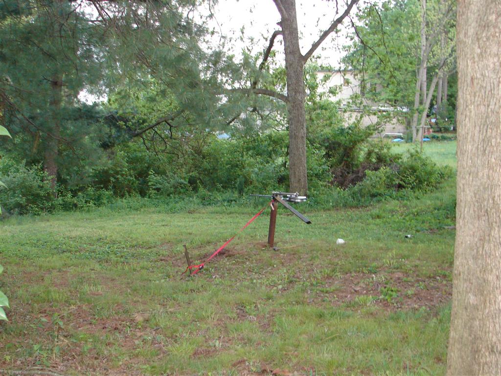

Finally got the bender setup and got a little work done on the truck. The first thing i found out was that 160 lb. of quikrete wasnt gonna cut it......... after rigging it up to stay somewhat standing, i resumed bending some tube.
The first project was a bumper, mainly to protect the corners(for reasons outlined photographically above) . Turned out pretty good for the first bends, not totally symmetrical, but close enough for this already crooked unibody jeep.

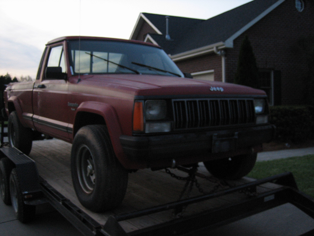

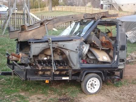

And just for fun, one of the MJ the day we brought it home, a couple years ago now.
