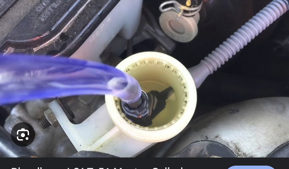

Not sure if the truck works for that application but I bled the piss out of my t56. Then took a mighty vac hand pump with the small pointed tip. Stuck it into the reservoir where the hose comes off of it. Pumped it up to a decent vacuum left it sitting for 5 mins. Pulled vacuum hose off and it sucked the fluid back in and was 100 percent perfect.
Pic for example
That's the way I bleed my T56s that I don't have remote bleeders on, but didn't work for this one.
