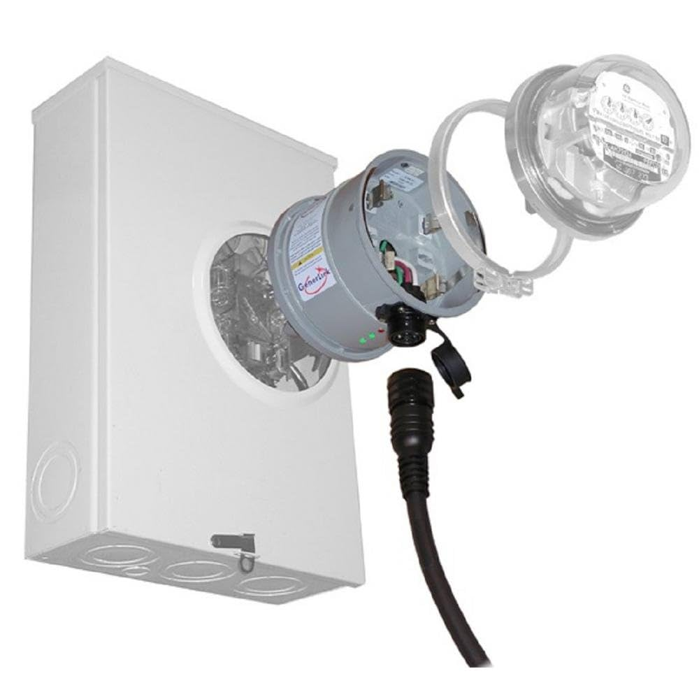

Something like this would do what you are describing safely.

My next route of consideration. A light comes on if it detects grid power is back up
