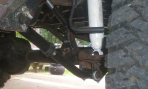

http://www.IronMan4x4Fab.comwell sorta i still have to lengthen my front and rear driveshafts i pulled off of a couple exploders from pull a part ,i will be running front d shafts from mid 90's explorers front and back on my 91 xj with a sye in the rear.front springs are from bds 4.5 with a 1.750 spacer,rear springs are a bastard pack i built from xj,s 10, and yj leaves.upper and lower ca's ,trackbar,rear lift shackles and tie rod are all built by Andy from Iron Man 4x4 Fabrication,front bumper,rear bumper and rock sliders are coming soon Andy and myself are going to make these and install them in another couple weeks when he gets time.I am really impressed with this setup I know alot of people say that 6.25 inches is alot for a short arm setup but this really works well,I have driven this thing to work for the past week and that is 42 miles each way and at 70 to 75 mph and it handles really nicely,I am still geared 3.55 for now but will be going to 4.56 soon. sitting on 33x12.5x15 on 4.5 inch b.s. rockcrawler rims fenders trimmed 1 inch on the front and 3/4 inch rear.I have included some pics of the suspension that i got from Andy and i highly recommend him for your suspension needs for your tj,xj,or zj he has a great product line for an even better price.Thanks a million Andy.

yeah i know i tried to post some but it said a security error had occurred if anyone knows how to get em to post i can email them to you
just create a account on photobucket.com or some other image hosting site. then copy and paste the image code into the reply box.
thanks but i sent them to photoshop resized and saved them they are a little dark so i lightened one of them up it doesnt do it justice though
