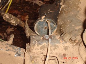

There are several reasons it may not work. You could have a vac leak for one. You can make a round or two of electical tape around the male ends of the disco and then re-install the boot if it is leaking there. It could be the switch that is on the transfer case that switches the vac when you put it in 4wd. There are many way's to fix the problem if you know exactly what the problem is. you could remove the disco from the axle, place the collar in the locked position and place zip ties one either side of the axles so that it can't move, then re-install the disco w/o the vac line attached. Make sure to plug the vac line holes. You can also go buy a cable actuated disco for about $200. Or, you can even red-neck engineer it like this one. It is attached to a lawnmower throttle cable ran up to the cab.
