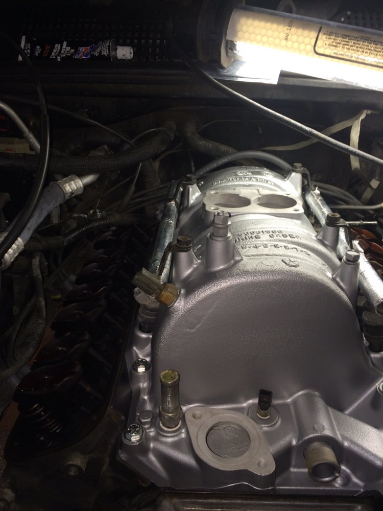

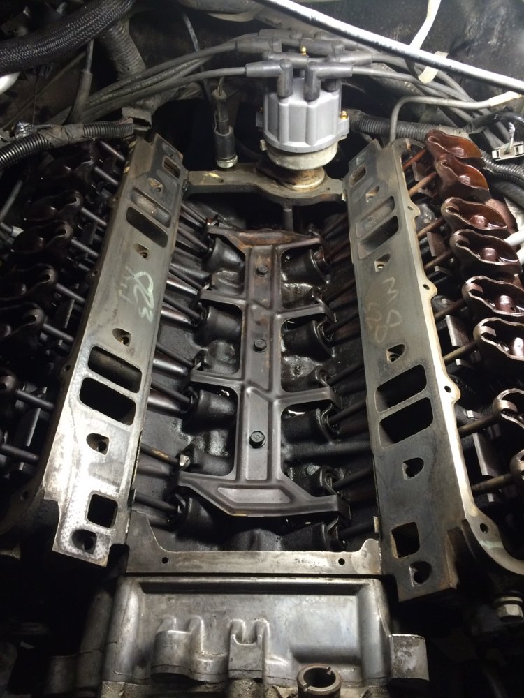

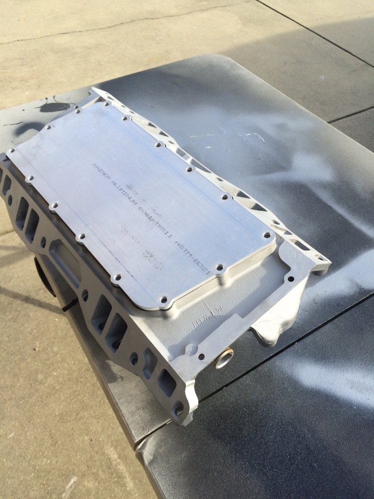

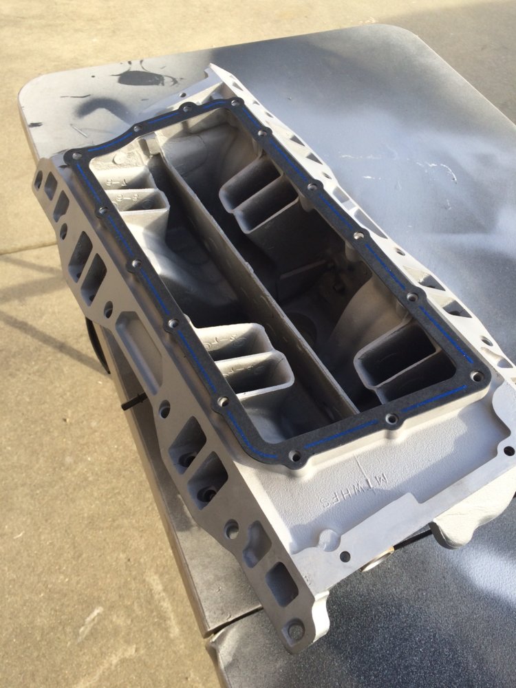

Is this the one with the big beer barrel intake manifold like in the grand Cherokee 5.2? If so the underside of the intake manifold has a block off plate that separates the plenum and runner from the oil / lifter galley. It’s made of tinfoil and over time can loosen over time and spit the gasket leading to crankcase gasses being sucked into the intake runners. Causes poor mpg, bad throttle response, and can through emissions codes. Hughes engines has the cure for cheap.
This is when I did one in my ZJ
