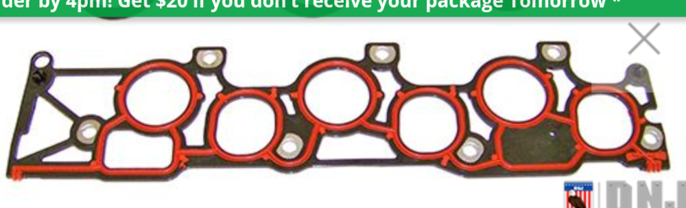

I bet it's the intake gaskets, cause they will dump coolant straight into the intake port. Pass leak down and compression test though if it is the case. Motors were known as rod benders for the intake issue. Would also pull coolant in under vacuum..

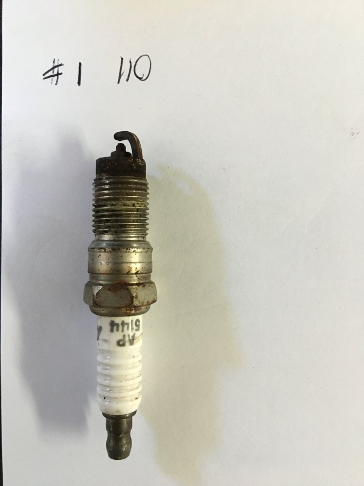

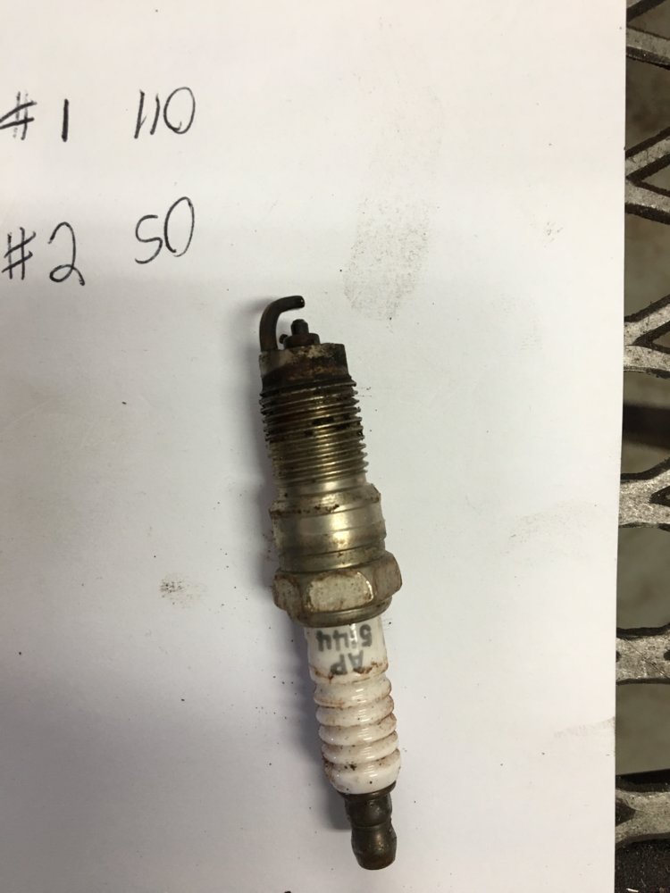

Pulled a plug and tested compression on it.

You might do a wet compression test on it, coolant will wash the cylinders....

When I was starting on mechanics.... I remember vividly a kia car that had water for fuel... Wouldn't hit on starting fluid. Did compression test, showed low low <30 psi. Figured the belt went. It went to another shop that checked the fuel, did a wet test and drained and refilled tank and it was going again. The 4.2 intake gasket design will literally dump coolant straight into the intake port. I have seen head gaskets bad enough to leak enough to wash cylinders as well, but wasn't a 4.2 Ford v6..
If you pressure test the cooling system for a while, then bar the motor over, you may find the coolant in the cylinders when the intake valve opens.. though if that's the case, should be cylinders 1/3 or 4/6 pic for reference..

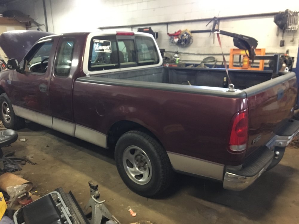

2WD Extended cab long bed. I did not even think to do a wet test. I'm betting its the head gasket. I swear I smelled exhaust in the coolant bottle....
This truck will be sold. If anyone is interested let me know. Lets start at $1250 OBO. @a_kelley you expressed some interest but have not responded to my pm's. I have a signed SC salvage title in hand.
