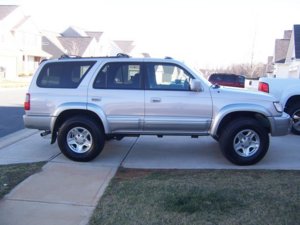

99' 4Runner limited with 220k on the clock:driver:
2 years ago when I bought it

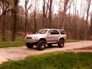

after home-made spacers and nitto 295's
Looks good man. My DD 4runner looks pretty much exactly like that, but with 255/85 KM2s. I have a set of 285/75 Nitto TGs waiting to go on though, once my KM2s wear out - which will be soon enough (I think I'll be lucky to get 30k out of them).
Then in the last month.... haha

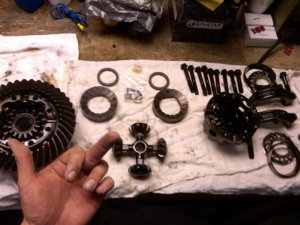

-Lockers... I went with a loc-rite for the rear, cheapo I know, and a spartan for the front ( I haven't installed the front yet, I'm waiting to do manual hub conv. first so I can unlock a hub for steering on the trail... anddd about 4 spare CV's, haha)
....Big thanks for Universal Automotive and Chris at East Coast Gear Supply :beer:

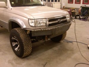

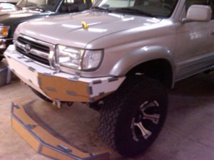

I wanted a plate bumper, but didn't have $1000 to blow, so I made one....
I think this should hold! hahaa... Cardboard mock-up

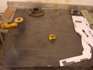

Picked up some 3/16" plate...
Internal supports made with 3/8" plate
Bumper...continued
Items I still need to do for the bumper...(I simply ran out of time on spring break)
-Put lights in...I want to make them recessed
-Cut the thin opening for the winch fairlead(already has internal horizontal mounting plate)
-Sandblast/Primer/Paint... I have color matched metallic silver to match the trim

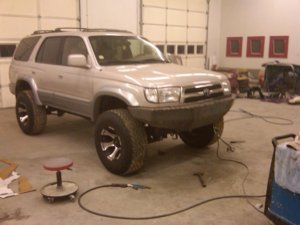

Here's the bumper as of right now... I had to get to a 'stopping point' because I ran out of time, and classes started back...
Scotch-brite'd / and rattle canned'...
