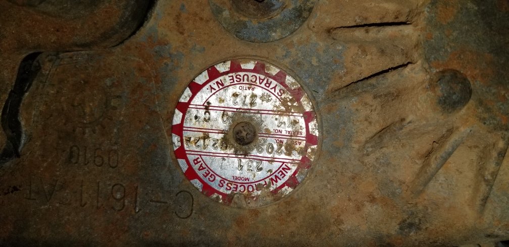

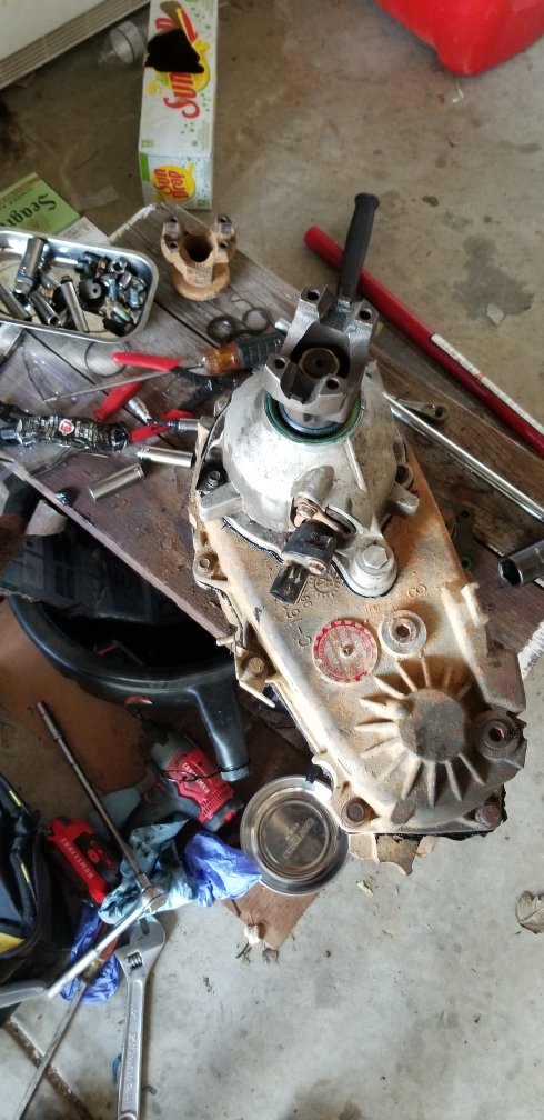

Best way to tell is by the tag on the case
it's a round tag and will say what the case model and ratio are. That will tell you if it's the same unit. You can change them between vehicles, it will bolt up, but there are input shaft differences (length, spline count) and also, if it's a full time case, the front output will be setup to attach to a CV joint as opposed to a double cardan joint. You can change from a np231->np242 straight forward, and gives you a 4 high full time option, but there aren't any real "upgrades" for the 242, like slip yoke eliminator kit, or 4:1 gear upgrade.
Here is where the tag is located next to the rear yoke. And a close up of the tag. It has the case model at the top. This is a np231, then the ratio is at the bottom of the tag.
