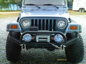

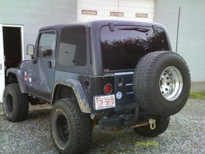

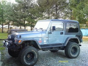

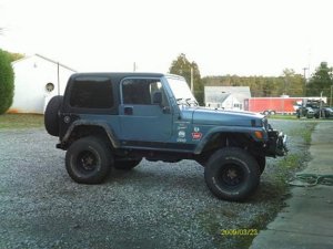

Wheeling this until I get the buggy done!
99 tj
8.8 rear 4 linked
hard top with soft top and half top with wind jammer
warn m8000
warn rocker gaurds
