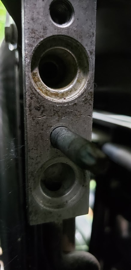

I need the hoses to go from my A/C radiator [ this 'flange' ]
I bought some #8 fitting for it [Omega 35-3105] Close but no go,
The rest of the system is pretty standard, #6,#8,#10 with oring.
What the hell is this ? Maybe a different name ?

I think it's called a "stupid fucking Ford" fitting. A nut goes over the stud on the bottom and a bolt goes through the threaded hole at the top. The end comes clamped onto the hose. Do you know what vehicle the condenser coil is from?
What your look at is the stock 2006 e450 6.0(oh-no) condenser.

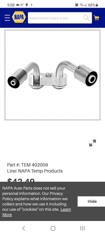

I'm not saying it's the same but I've used this fitting before to adapt to a ford ac condenser

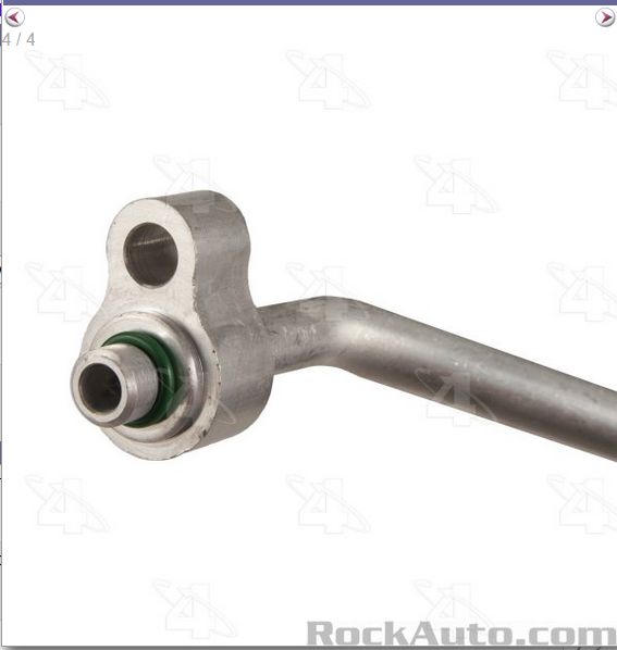

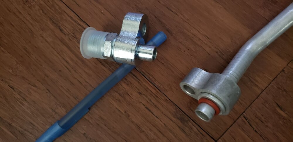

Well it looks as if mine were close.
I got a NOS [New Old Stock] hose.
I can take 45 deg off the edge and call it good.....

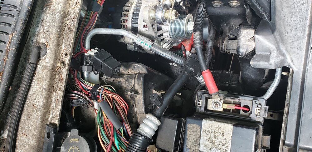

I keep forgetting that you all ain't there.....
Here's a better shot :)
