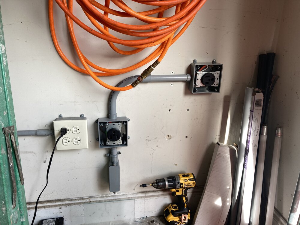

I was in a similar situation except I didn’t have 220 at all in my shop. I ran 3/4 grey conduit from my main panel into my garage and pulled 6 gauge which terminated into a 6-50R (3-prong receptacle). Last week, I added another receptacle to that same circuit to run my plasma and compressor (combined <40A).
I started going down the road of adding a sub panel but that became a lot more work for something I truly didn’t need. Do what works for your needs and keep it simple.
