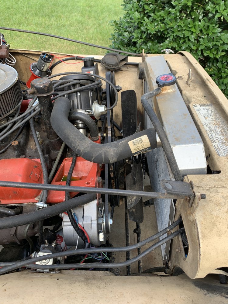

No shroud is a big deal. Depending on your fan setup, you could just be pulling air around the radiator rather than thru it.

What fan?
Stock seven blade.

I’d say a shroud would make a big difference for you. So long as your water pump is in good working order.

Definitely needs a fan shroud. Had a buddy try this. Hauled all the way to Moab, first trail his started overheating. Spent the whole evening hand making one out of some aluminum we picked up at a fab shop out there.
I'll also say that for many years, I ran a flex fan with NO shroud on my 304 (Commando's use CJ radiators) with no overheating issues once I replaced the swiss cheese radiator... which shouldn't be a factor here

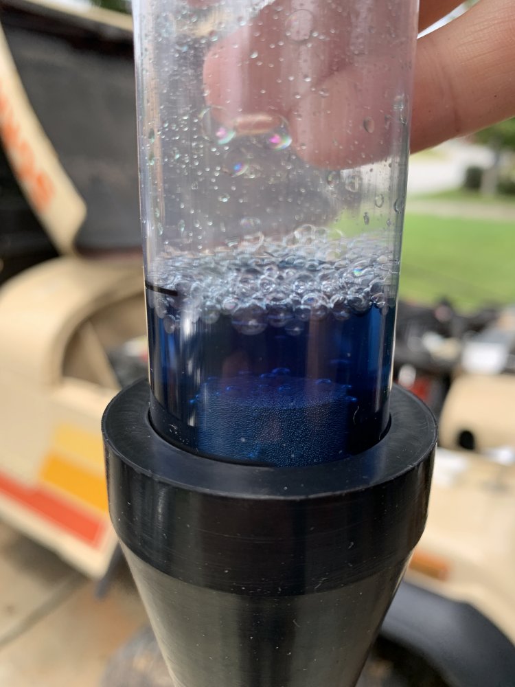

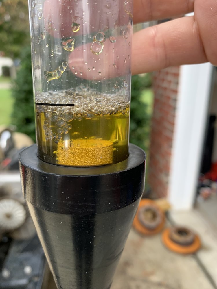

I have no experience with the actual hf combustion tester but it looks identical to the kit we use at work from Napa. It should work fine. If you get it you can test it by filling it up then sampling from the tail pipe, if it changes color you know the fluid is still good and works. Then you can empty it and refill to test actual radiator. Drain a little coolant first, if it's bubbling up it can contaminate the fluid in the tester.

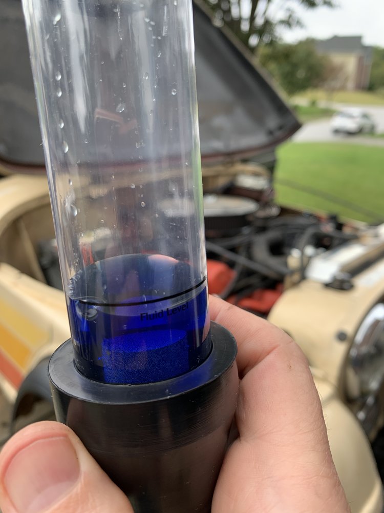

Did a combustion gas test on the radiator and the fluid stayed blue; then tested it on the tailpipe exhaust and it turned yellow.

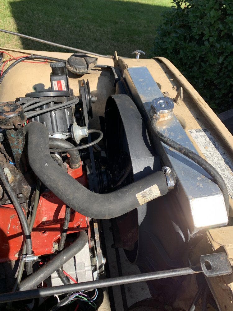

Buy a shroud
