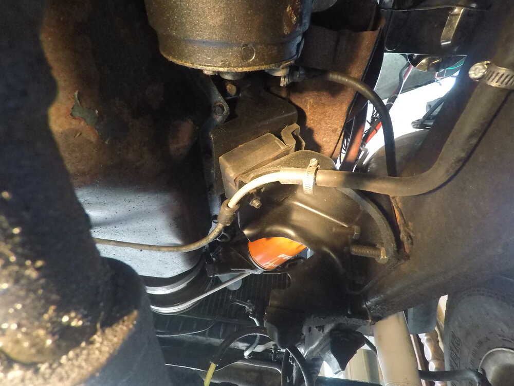

Well I was wrong about which was broken - the driver side is certainly ripped apart. I didn't jack it up to check the pass side but it may only be stressed or the rubber has pulled away from the metal. And the fact that the passenger side bracket is clean while the driver side looks much older should confirm that thoseare correct.

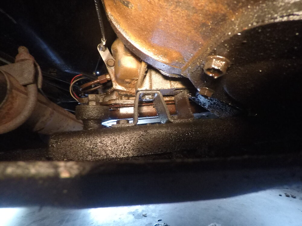

I also attached a pick fo the rear mount. Does that look normal or is the outboard bushing way too high to be helping? Finally does that look normal for the reported 1/8" of slack in the bolts into the case? If the bushing is doing nothing, as I am thinking then I am back to the opinion that the stock mounts may be good enough.
When I installed the rebuilt 360, I replaced both engine mounts. One looked good, & one was starting to separate. Don't remember which now, but easier to do both while the engine was out. Your bushing is probably ok; just hard to see through the grease.
Well I was wrong about which was broken - the driver side is certainly ripped apart. I didn't jack it up to check the pass side but it may only be stressed or the rubber has pulled away from the metal. And the fact that the passenger side bracket is clean while the driver side looks much older should confirm that thos eare correct.
Yeap, the DS mount gets pulled apart... I ran $5 Chiwanesse/Indian to $50 "Made in USA" mounts... all destroyed within 1-2 rides/100 miles until the "chain" was employed. A wee bit ghetto to most, but has been working for 20+ years :D
I'm not familiar with all the various CJ mounts, BUT... a couple things stick out to me:
- Agreed, the LOWER torque arm bushing appears to be either shot/MIA or stud grossly misadjusted
- There *should* also be a rubber mount UNDER the torque arm and until confirmed good (they'll disintegrate when oiled down), would also be suspect given the the amount of movement in the torque arm
