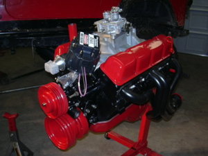

Is it a stock rebuild or did you add any performance parts, like a hot cam?

It is bored .30 over, 9.5-1, pistons, moly rings
crank was turned, mains .20, rods .10
heads were shaved just a smidge, ported, not polished
high performance timing set, high flow water pump, high flow oil pump
RV torque cam 280 grind
edelbrock torker intake, edelbrock thunder series 4BL offroad carb
everything else is stock,
good thing about AMC 390's and 401's, everything is forged

Let me know when you are going to drop it in and I will give you a hand. I have been slammed this week at work, looks like you did well though.
Nice engine stand, by the way.

Sounds like some good mild performance upgrades. Nice low end torque. Let us know how you like it. Never too early to start planning for my next 401.
