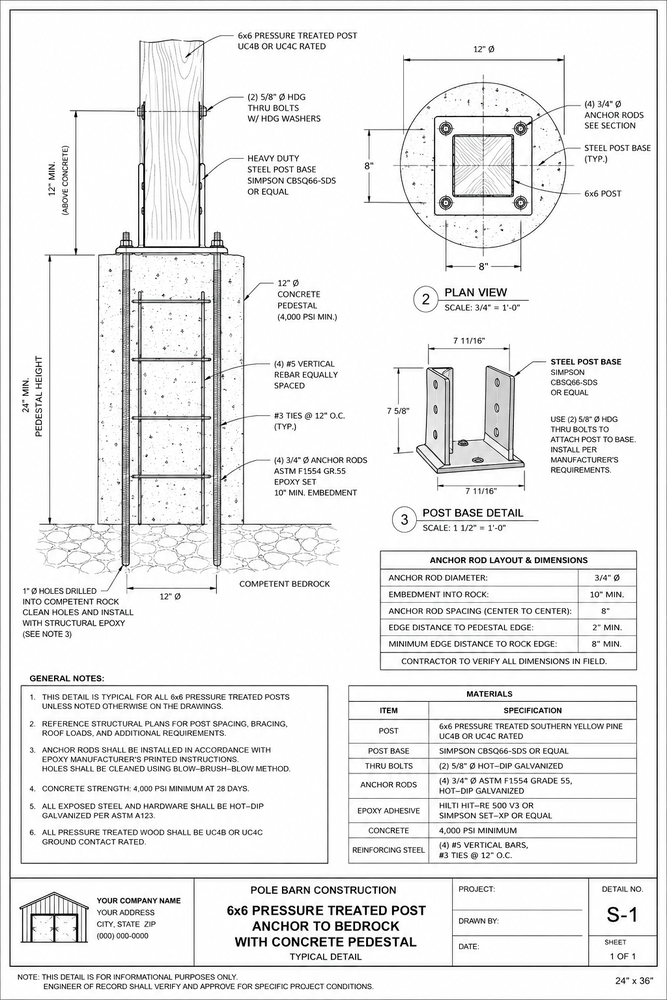

I'm in the early planning stages of a shop (30x 30ish) and am having to do this in phases. I've narrowed down the building type to a pole barn / post frame (looked at Miracle Truss but budget likely won't allow it) and am planning to build the roof structure now and use 2 20ft containers for dry space. When funds allow I'll pour a slab, frame in the walls and finish the shop out and sell the containers (doubtful, very). Typical pole barn post embedment is 4FT, however I have solid (likely competent) rock at or near the surface over a large portion of the proposed shop location. Research has turned up typical details like this:

This method will solve several problems, assuming competent rock can be located. I'm within the city limits so I'll need to submit plans for a permit but since this is 'covered equipment storage' they should be limited to a truss drawing, post attachment and site plan / sketch (I have not yet verified the requirements with the city yet). Local pole barn builders won't pull a permit so I'm proceeding assuming I'm the GC and will DIY this.

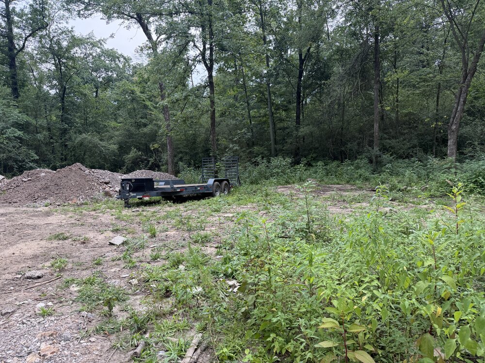

For reference, the shop will be built here. The flat area to the right of the trailer is exposed rock and it pops up in several other locations on this corner of the lot:
to have competent rock and be allowed to pin to it you will most likely need an engineer to verify which may require several borings. AKA alot of extra money.

You also will have the potential of differential settlement if some columns/footings are on rock and some are bearing on soil. Maybe not as important on a structure like a pole barn, but still something to look out for.
This. You'd probably need uplift/pull out tests.

This rock is halfway between shale and a granite - I wonder if I could core drill and then set my posts like a typical pole barn?
