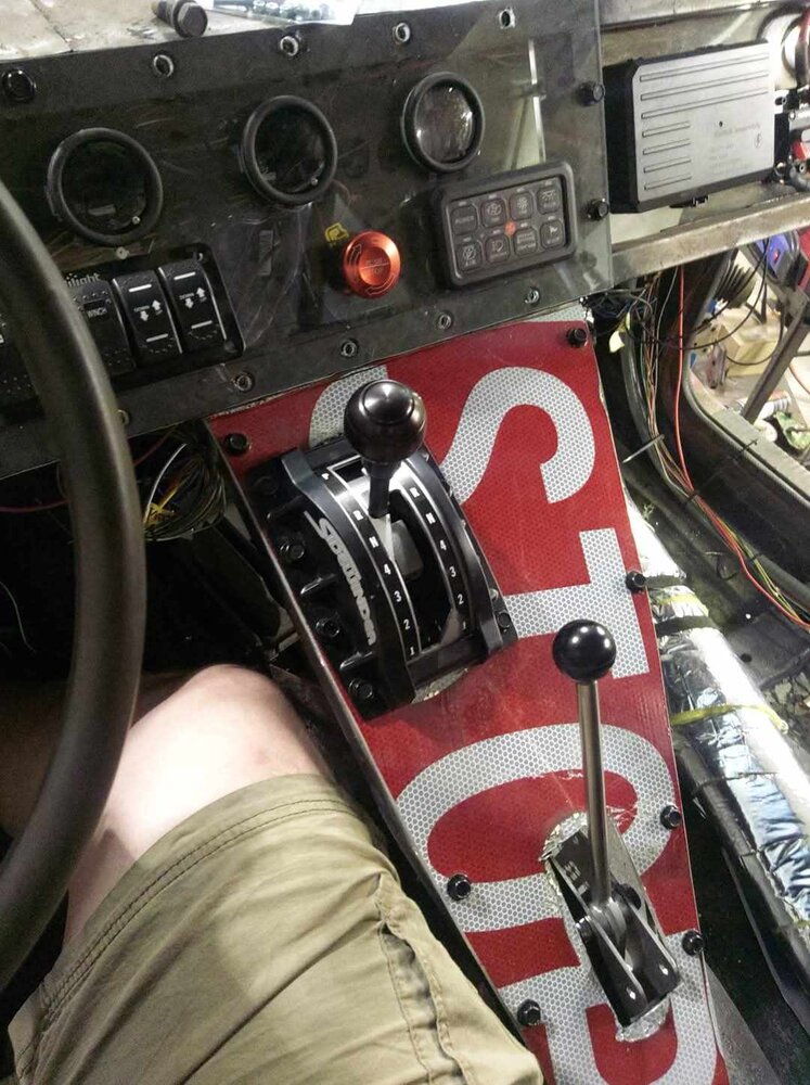

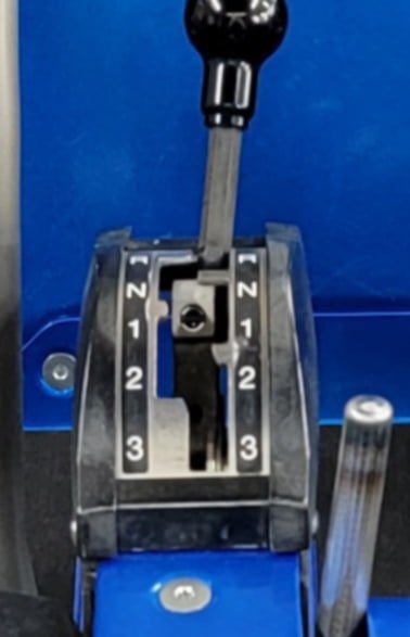

Buddy #1 - All new "west coast" build (tube chassis/big LS/reverse pattern 6LX0E/Atlas/10.5" steering axles) running the SHO "M40 Speed Shifter" and LOVES it "for the slow stuff" (crawling), but doesn't trust it for the "fast stuff" (wide-open across the desert at 100MPH) where an accidental bump
Buddy #2 - Similar southern Commando (small LS/std. pattern TH-400/D300/tons/39.5s") running the hobby defacto Winters Sidewinder and isn't shy to tell everyone how much he hates it/what a steaming pile he believes it be... despite the fact that he refuses to cut the gates = MUST look at it to know "where it's at" in the pattern and it makes a fawking racket banging from gate to gate.
I was set on the SHO shifter, but input from #1 that's it's geared towards "race"/"buggy" and even with a stiffened detent (inside tranny to "cocks comb"), isn't as positive as he'd like and now wished he'd gone Winters...
Having ridden with #2, *I* was aggravated AF just watching/listening to it!

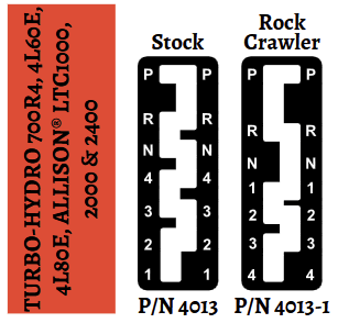

I have the Winters Sidewinder Standard Shifter (no lockout) with Rock Crawler pattern/gate in my buggy. P/N 4013-1 shown below. 10/10 would recommend.
It has a solid engagement feel in every gear. I like having the gates to keep me in the gear I want when I'm hammering down on something with one hand on the wheel and one hand on the shifter. Usually if I'm slamming it from forward into reverse, it's from 1st gear. If I'm in 2nd or 3rd, I'm fully committed to whatever the outcome is regardless. Even with the gates in place, you can still get to reverse from 3rd reasonably quick once you get a feel for it.

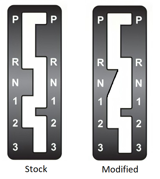

How I modified mine.
It lets me go from first to reverse and from second to reverse in a hurry.
From second, because of the slanted cut the shifter will get moved to the right no matter what. Just have to give it a straight forward push.
I haven't had the need to go from third to reverse yet.
The only negative is going from second to first if you're hard on the brakes, you could over shoot and end up in neutral. I am just mindful of it when I'm driving like I'm racing an U4 race.
