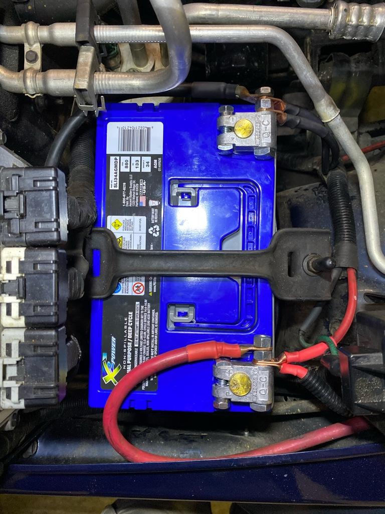

I posted this over at JeepForum, but it’s not getting any responses (which is surprising)... Thought I’d get opinions here, before throwing parts at the problem.
I have a 2004 TJ Rubicon. The battery, terminals, and leads are all new, as of January. I’ve had no issues at all with the cranking or charging system until now. (And just to be clear, there was no problem with it before January - I simply replaced the battery because the old one crapped out. And I replaced the terminals and cleaning up the wiring because I’m a little OCD).
On Sunday of this week, I noticed it cranking a little slower than normal. It progressively got slower and slower until yesterday evening when it wouldn’t crank over at all. I put a volt meter on the battery (without the engine running) and it’s showing 12.95 volts. With the engine running, I tested the output of the alternator and it was producing 13.88 volts, and the battery was showing 13.86 volts.
In my opinion, this tells me the battery and alternator are fine. So why did it begin turning over slower and slower until it won’t turn over at all? Could the starter be bad? Deteriorated to the point that it’s drawing more current than the battery can produce?
Thanks!
