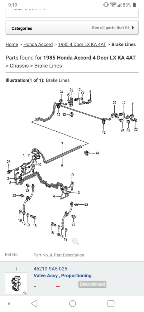

so Im doing a disc brake conversion and need a 1985 Accord front banjo bolt. cant seem to find a way to cross reference to a dorman part number. parts houses come up empty. rock auto same. anybody got any suggestions?
Believe it is part 18 in diagram

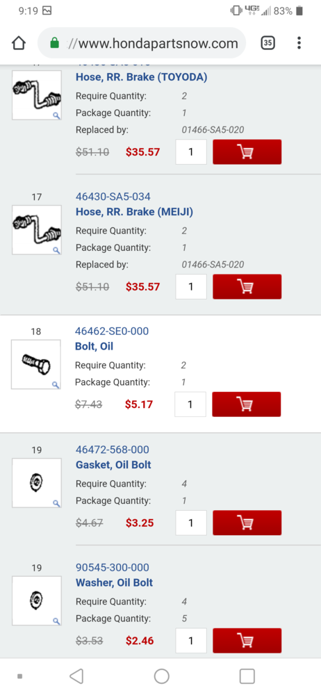

I can't find a doorman number but i found plenty for sale on Amazon and different web sites from the part number in the diagram above. Also couldn't find any bolt dimensions. Hope it helps.
This says it's the same bolt on just about every car Honda ever made up to the current model year, including the 1985 Accord. M10x1, don't know the length.
1976-2017 Honda Bolt, Oil 46462-SE0-000 | hondapartswd
