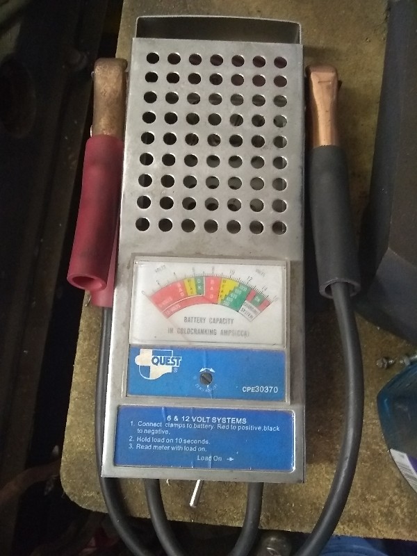

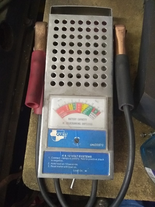

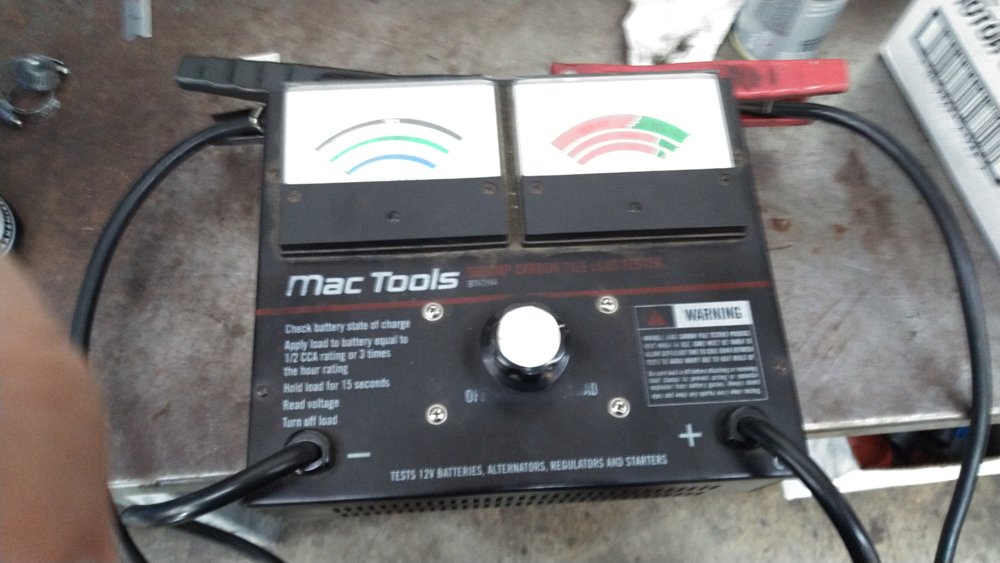

Fwiw harbor freight has a carbon pile battery tester for roughly 50 to 60 bucks that looks similar and works just as good as this Mac tools one we have at work.
I have the hf version at home. That and a decent charger and you can do your own testing and forget about advance or auto zone.
