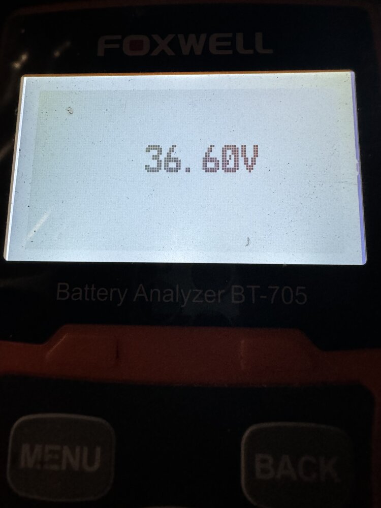

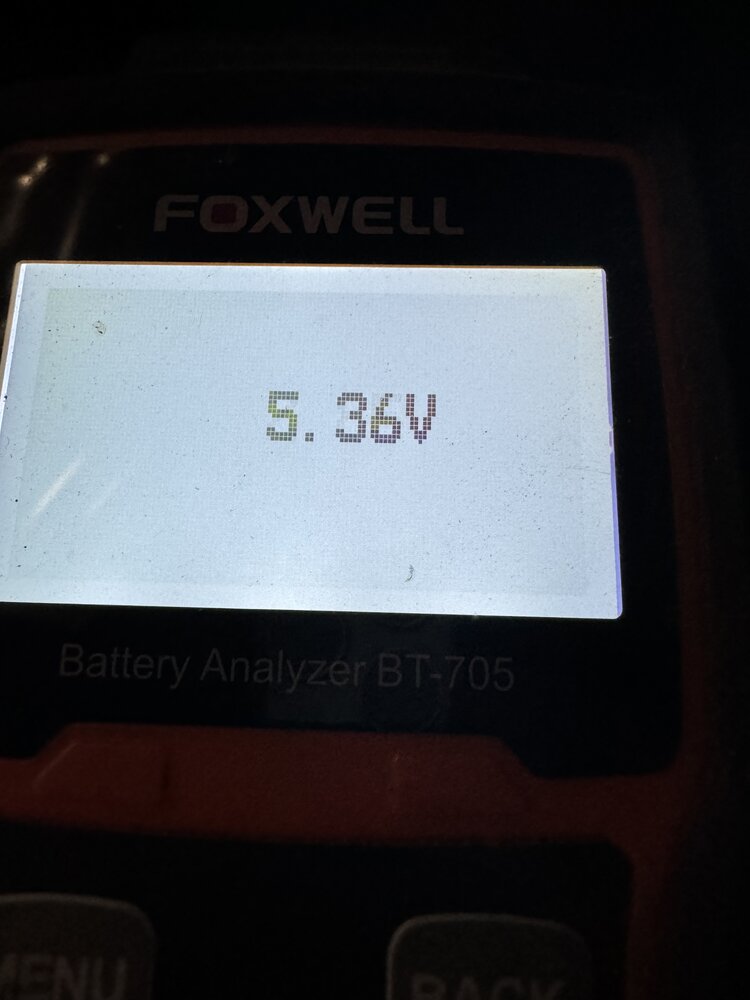

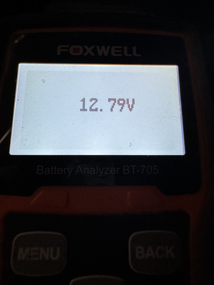

At the shop, I put my tester on the battery, and it is showing 36.60 volts and won't go further, into testing mode. Cranked it up, it showed 14.8 charging. Shut it down, and it's now 12.79. Five minutes later, it's 5.36v. But cranks right up. Tester is straight to the battery lugs, not the cable clamps.
