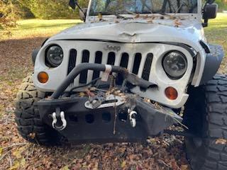

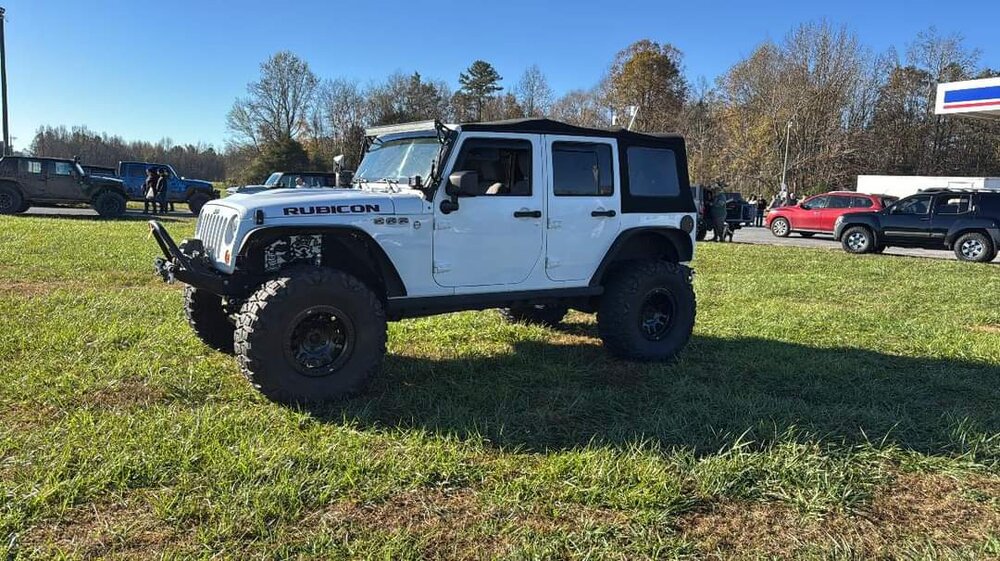

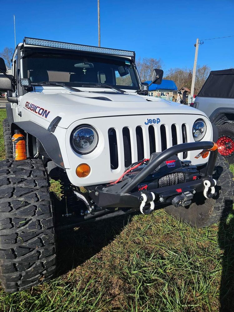

This Jeep had taken a trip down the owners steep yard and smacked a tree. I tore it all down and got the parts ordered. Once the new front end parts came in I was able to take it to a bodyshop to have the frame pulled back into alignment and have it painted. Then I added trusses front and rear, inner C gussets, hydro assist and the new lights. The owner has already enjoyed it out in URE and did well with no issues.

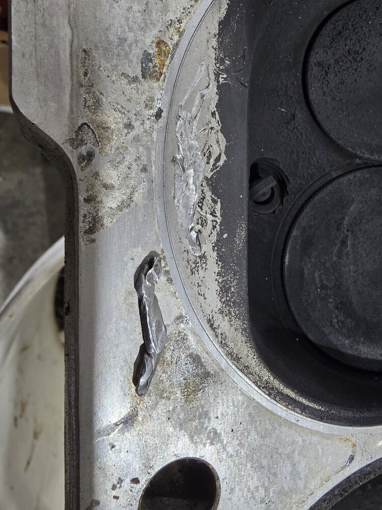

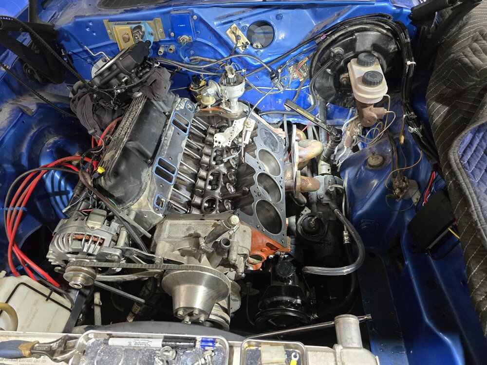

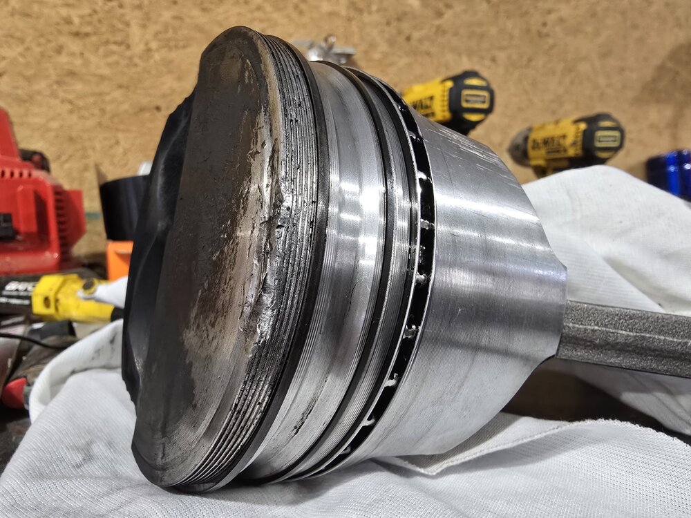

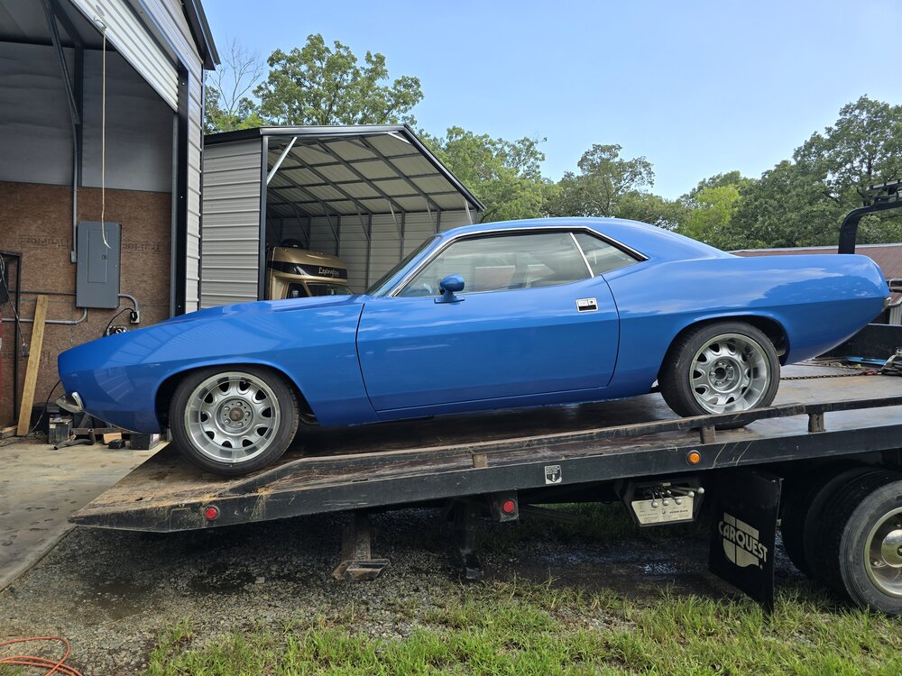

Is that a tip from a deburring tool?
I really don't know what it is or where it came from, car wasn't running when it was dropped off, been sitting too long with bad gas. So idk if it was in the intake or cylinder before I got my hands on it or if I dropped something but either way I'm taking care of it.
Wow. So is that a simple replace piston and rock on or is there a whole slew of things that will need replacing?
I'm consulting with a professional engine builder locally to help me make sure I have everything I need and nothing is overlooked. I'm meeting him Sat morning to look at it in person and tell me 100% what to order. I already have gaskets and those type of parts coming in the mean time.

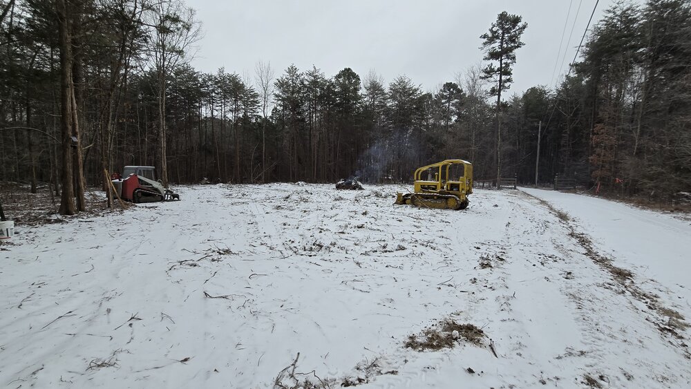

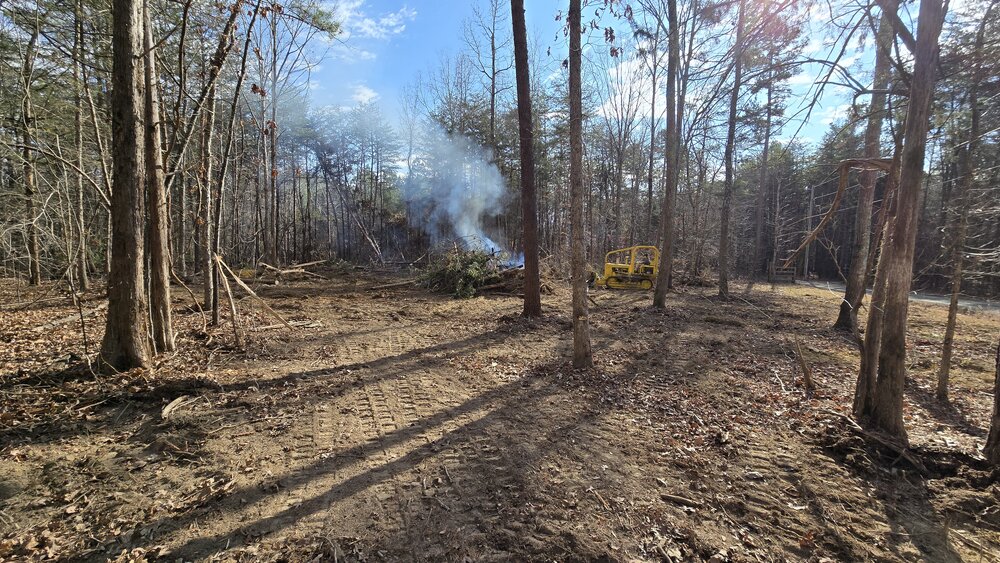

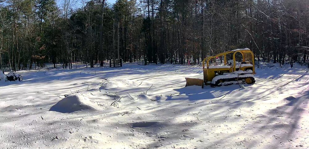

Made more progress clearing the land a little at a time and then progress stopped due to a broken bolt.

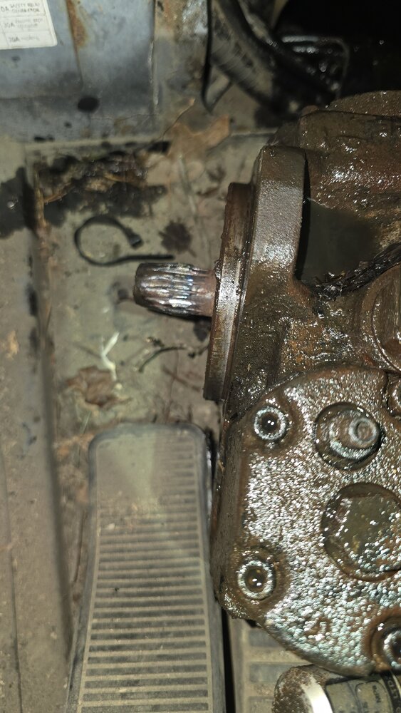

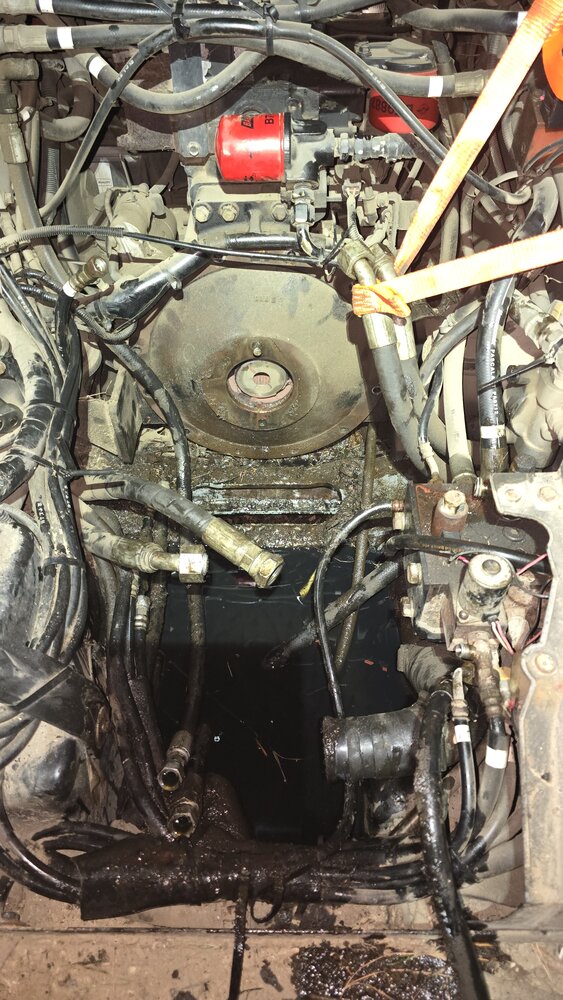

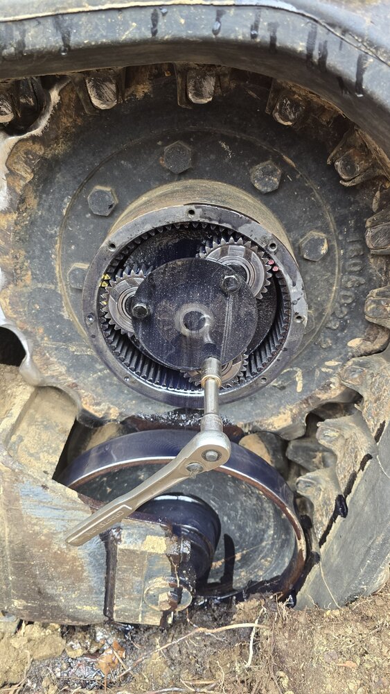

Top bolt attaching the hydraulic pump broke or had been broken and ate up the input shaft and coupling on my brothers skid steer.
If anyone needs to know how to tow a 2006 Takeuchi TL130 out of the woods you have to remove the cover for your drive hubs
Then remove the 3 gears, there is a shaft in the middle that I pulled and reinstalled the plate with the 3 gears and the cover to keep everything lined up.

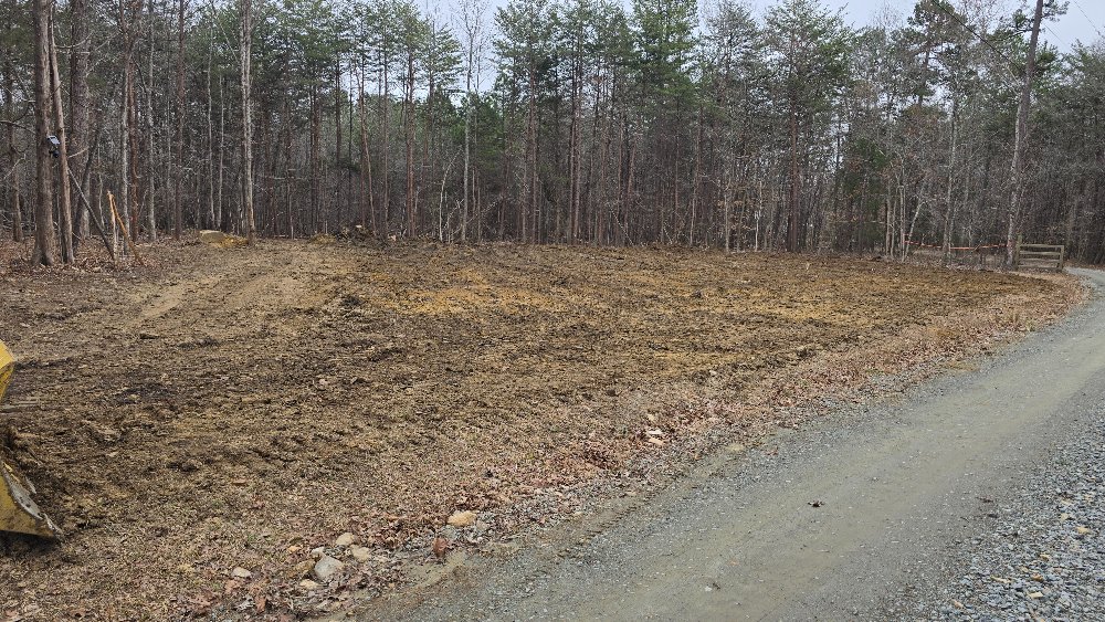

Building permit approved and in hand, the ground is starting to dry out and today I was able to start pushing off the topsoil and organic material. Looking forward to this warm and dry week coming up so I can finish grading, concrete guy comes at the end of next week.

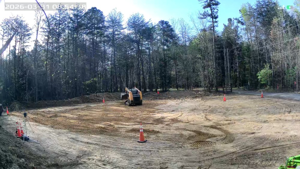

Between the wet spells I've been getting more and more grading done. And finally today some of the last loads of dirt will show up and the concrete contractor is there to finish grading everything.
So how big is this and what kind of dirt cost were involved if you don't mind sharing. IF I ever get to this point I have a grade I have to level.
