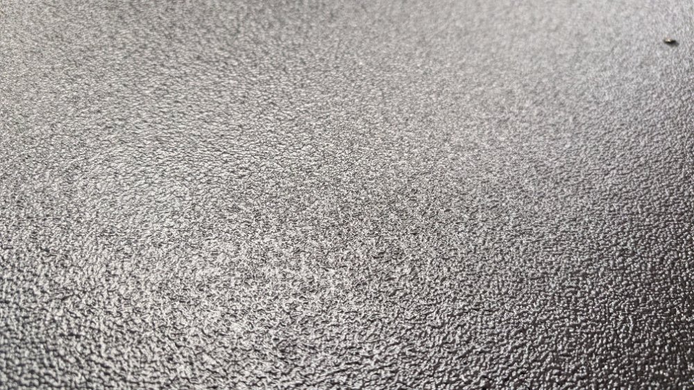

raptor looks pretty good when done, and is great for light wear areas But, It doesn't wear like bullet liner on line-x. in the bed if your using it as a truck as a truck. I have raptor lined a lot of stuff over the years, and a working truck bed is not a place i would recommend it be used. Other areas, like fenders and internal/external panels it will do great there. it's great for any place that doesn't have weight pressing down while being pulled across.

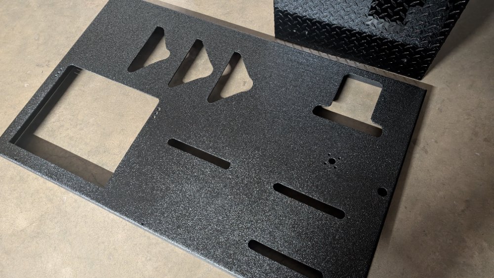

Holy plastic wrap! Dude took no chances on over spray. It doesn't atomize that much. We spray a very similar product at work. We spray aluminum and steel products. All have to be coated with a primer. We use an epoxy. I've looked at doing some personal aluminum works and using an acid etch primer.
Any experience with that sort of base? Edit: (directed toward anyone)
