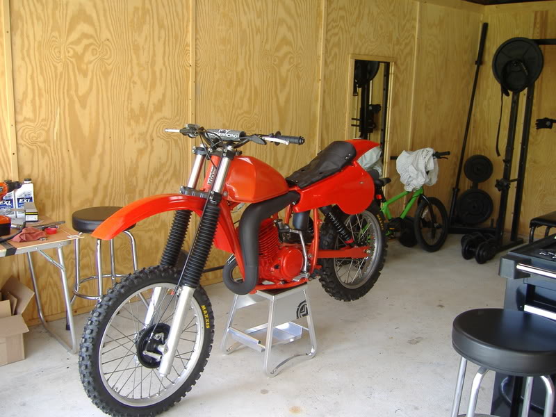

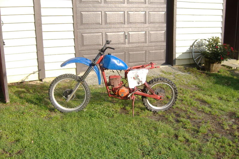

I have been working on this for my father for a few months then he took over and finished it super nice.
Before....

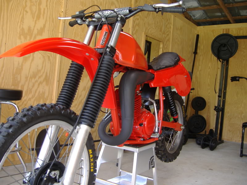

After
Here's a spec run down
Engine Rebuilt by Vintage Elsinores 36hp stock...41hp now
New frame...stock was cracked up
82 CR480R 43mm front end with dual leading shoe drum brakes
Maxxis 21" front Maxxis 18" rear
Progressive Rear shocks
1980 Model Swingarm
VMX Racing OEM repo plastics...1980 Side panels
Also I am in an Ankle splint due to the compression on this thing yesterday.
This post-vintage bike is one of the fastest of it's day
Also this bike was my father's in 1979 when he brought in new...after it broke his leg he sold it...now it's back home.
