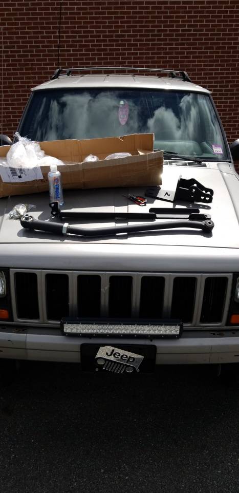

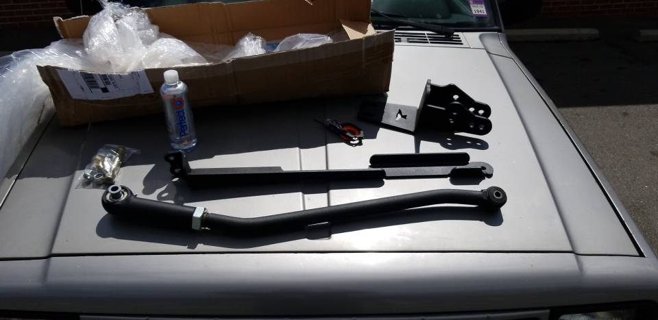

My track bar, bracket and brace finally came in and it looks amazing and beefy as all get out. Cant wait to get it installed.
