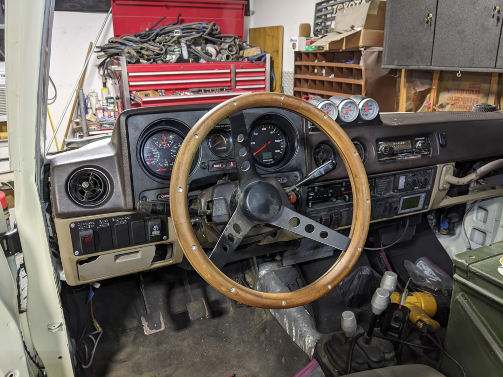

That's what I got in my truck, triple flush. You can see them bottom right in this frame.
